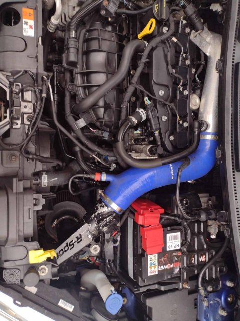

I'll take a look at WTA and remove the turbo inlet to see the turbine wheels when I get the car back it's currently being fixed for MAP sensor problems. It does have an aftermarket induction kit the cone type but I'm not sure which brand, it also has a airtec stage 2/3 intercooler not sure which it's tall and aftermarket boost pipes. Is it dangerous to run a hyrbid turbo without a map/tune? I bought the car from a dealer and I think that it's been put back to stock for selling after previously being mapped.
Here's a pic of the induction kit

I have an X47 and it does make that whistling noise. On WOT mine makes 26psi with the Pumaspeed map, so 18psi seems very low. You can remove the turbo elbow and check the size of the blades as ones in the hybrids are noticeably larger.
