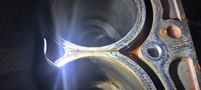

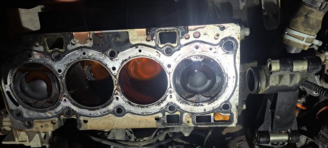

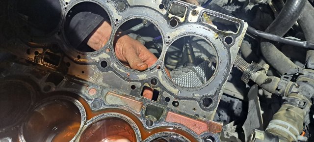

I'm X57RS 30psi at 330hp Dynojet also running xdi hpfp and Jag 30% injectors. I opened mine up cause I was overheating and consuming coolant quickly and my catchcan had the milkshake in it. I had just crossed the 100k milestone but had already had the turbo for 25k miles but the fuel mods for about 15k miles. It's a 2019 and I've been the only owner since 21 miles. When I opened it up there was plenty of coolant in cylinder 3. Since it's my daily and my work truck I bought the pumaspeed shims because of a crack in cylinder 3 with evidence of cylinders 1 and 2 starting to crack or about to crack. I installed the shims with the toughest one to install was between cylinders 2 and 3. New gasket, timing belt only(reused the original tensioner), new head bolts, new pulley bolt, and added the barsleak copper seal. First startup was rough but it has been improving with every drive. Now I gotta save up for either a MRX short block and MRX head setup 7.5k compared to almost 10k for MRX long block. Other option is the pumaspeed bluetop 8k for fully assembled long block.

Nice picks. No cracks in the head from trying to compress liquid? I'd imagine much of that coolant spilled out of the head as the fasteners were loosened and it was pulled. I used the flakes with a prior engine; no disassembly. Like yours it would improve with each hot/cold cycle. But I had to stay out of the accelerator so... nothing beyond "nromal" cylinder pressures of extra normal driving.
