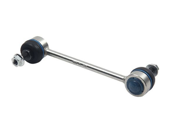

Here's one that apparently is used on the FiST, but I have not personally confirmed this.
BMW E36/E46 M3 Sway Bar End Link
Part #: 68510000

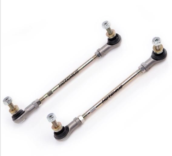

Hotchkis has one and looks the business.
https://www.hotchkis.net/product/20...-end-link-kit-from-hotchkis-sport-suspension/
Applications: 2014+ Ford Fiesta ST
Hotchkis Sport Suspension (25447F) 2014+ Ford Fiesta ST Front Sport Sway Bar End-Link Kit. Many performance minded Fiesta ST owners upgrade their cars with better tires and stiffer sway bars, but often these upgrades call for stronger, adjustable end links. We tested many end link combinations before finding the best solution. Our Front Sport End Links have high articulation THK resin ball studs for maximum range of motion, waterproof protective seals, CNC Machined Center Sections with wrench flats, and left and right hand threads for quick on car adjustment. For the optimum end link leverage length, they offer an adjustment range of approximately 1/2" in the front and are finished in great looking gold zinc plating. For the ultimate in Fiesta ST performance handling upgrade, we recommend installing our Rear Hotchkis Sport Sway Bar package (22447R) and our Front Sport End Links (25447F). Install our premium Hotchkis Sport Adjustable Front End Links and increase your Fiesta ST front sway bar effectiveness and end link strength.

Those are dope, and they better have that warranty for the price . Lol
