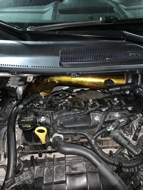

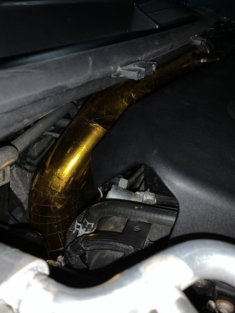

It would be beneficial for people like me and many others who installed an aftermarket downpipe and did not reinstall the heat shield (pita to reinstall). Gets too hot to touch after a long or hard drive. I put gold tape on my crossover and it made a difference in the temp of the pipe, I can rest my hand on it now.

I used DEI gold tape on my wrinkle black and its held up nice. If I were to do it again I would use a little spray adhesive, its starting to peel up around the valve cover bracket
