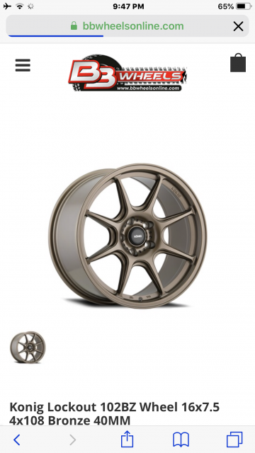

As the title suggests, im looking at Konig lockouts in the 16x7.5 et40 size....and am currently on h&r supersports.
Does anyone have experience with this particular setup in terms of rim widths/offset and ride height?
I plan on running a 215/40/16 on the rims.

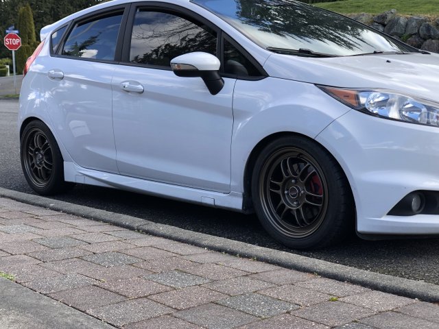

i dont know if i would be able to get away with any more offset/tire width WITHOUT rubbing at full lock or under compression on a corner, but i drive wild (that's why we bought a ST though right??? lol) that being said, i love the setup man! so happy i chose to go 16's, around 8.2lbs lighter per corner and the extra sidewall in 45 series is a nice buffer when hitting bumps. its super clean, and pretty flush IMO. i went with BF sport comp 2's because they were 90$ a tire, so i couldn't help myself. the one caveat to those tires IMO is they are a little louder than preferred, but i can live with it. i wanted an above-300 treadwear and these fit the bill at the time. the extreme contacts are a great series of tire, ive never tried the sport version, only the DWS and those rocked for what they were. i highly recommend 16 if your interested, 17's are too harsh IMG_1499 (1).JPG

i dont know if i would be able to get away with any more offset/tire width WITHOUT rubbing at full lock or under compression on a corner, but i drive wild (that's why we bought a ST though right??? lol) that being said, i love the setup man! so happy i chose to go 16's, around 8.2lbs lighter per corner and the extra sidewall in 45 series is a nice buffer when hitting bumps. its super clean, and pretty flush IMO. i went with BF sport comp 2's because they were 90$ a tire, so i couldn't help myself. the one caveat to those tires IMO is they are a little louder than preferred, but i can live with it. i wanted an above-300 treadwear and these fit the bill at the time. the extreme contacts are a great series of tire, ive never tried the sport version, only the DWS and those rocked for what they were. i highly recommend 16 if your interested, 17's are too harsh View attachment 40568
That looks great! I think I'll be fine with the Lockouts though. They're only an extra 14mm of poke (vs stock). Good to see this though for future reference. Maybe one of these days I'll snag a set.
