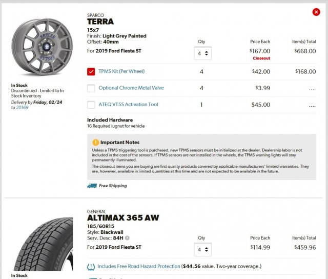

This is what I'm tempted to pull the trigger on, when the time comes. Any thoughts?
Again, stock daily driver / commuter (no autocross, track days, etc.) and leaning towards the "rally-ish" look. It sounds like options to do this on stock wheels are limited, at best.
I have generally heard that Sparcos are good wheels, and I like that rally look, but I would not want to get a discontinued model. If I bend or break one, I would want to have a readily available replacement. If I was going to buy a set of those now, I would buy five to have an extra one.
I think that going from a 17-in wheel to a 15-in one adds too much sidewall and compromises the best asset of the car, which is its quick and agile handling. That said, there are a lot of people on here with 15-in wheels who are happy with them.
Those tires strike me as too narrow and too low performance. I realize your car is going to be used as a daily driver/commuter, but I still would want to retain higher performance handling for the times when you can use it. Also, the tread width on that tire is only 5.7", too narrow to mount on a 7" wheel. That number is a more reliable number than section width, which is provided by the manufacturer and is subject to a range of tolerances.
149
188
CT
#19
Thats the stock non-st fiesta size/ our spare tire size on a 1" wider wheel. Should work just fine for a daily driver setup.
I run a 205/50/15 PS31 on a set of 15x7.5 rotas in the summer and am happy with the 15" life. Feels good man.
^^THIS!!
Especially the bolded parts, and less the negatives of going to a 15" wheel.
You might even have a hard time finding shops to mount a 185 section width tire on a 7" wide wheel (unless Tire Rack has already said that they would do this??).
