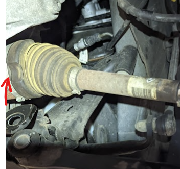

Q2: I should've asked Q1 before trying to install C1BZ-3B437-C without posting here first. But it is what it is. I attempted to install C1BZ-3B437-C. I first reinstalled C1BY-3B437-AA to use as a point of reference for what "felt" right. Then put the new one in. It seemed to seat within the splines just like C1BY-3B437-AA. But it still stuck out about 2" from the transmission.
I couldn't push it in by hand, so I tapped on this area to get the axle into about 1/2" from being flush with the transmission.
Since it wouldn't get any closer, I attempted to remove C1BZ-3B437-C, but she is stuck in there even with using a pry bar.
I've used a bit more leverage than what it took to remove C1BY-3B437-AA and I'm spooked to give it too much more. Any tips?
