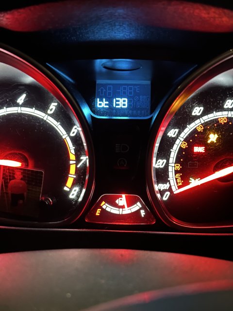

I purchased a brand new battery, but nothing. Still same “low voltage”. I sanded down the terminals connecting to the battery and nothing. I tested the terminals from the battery and gets correct 12.45-12.5 amps. I’m no mechanic and this is driving me nuts
in the “secret menu” battery shows great voltage while cars on 138, 120 when cars in accessory mode.

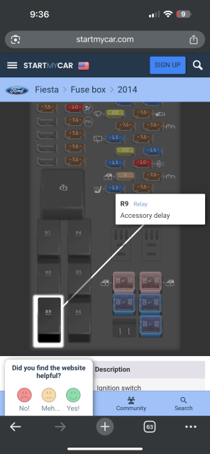

Next up is checking the relays but I’m not able to pull it because I can’t grab it -____- behind the fuse box.

Wow so to me this is totally left field. I checked every fuse and relay with multimeter and checking the relays with a 9 volt battery.
One came back with no continuity, ignition switch relay. Replaced it and BOOM! After almost a week. My radio volume is back, my climate control module stays on and air coming through. Would’ve never thought it was this relay. So hopefully if someone has the same symptoms I’m on their MK7 don’t over look the ignition switch relay.
