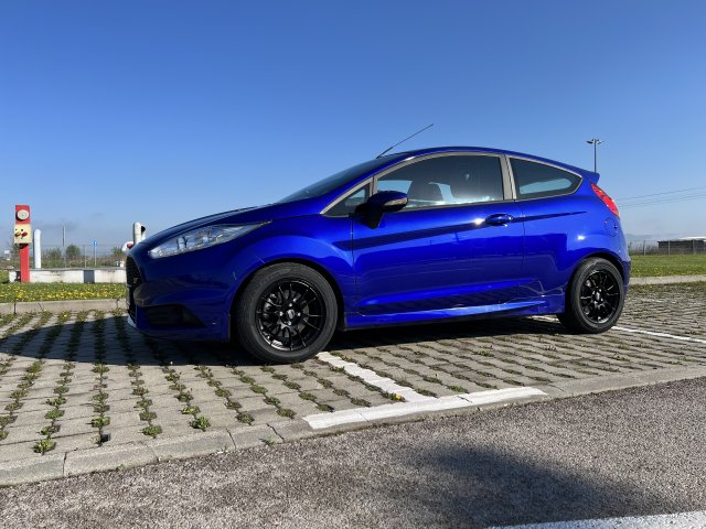

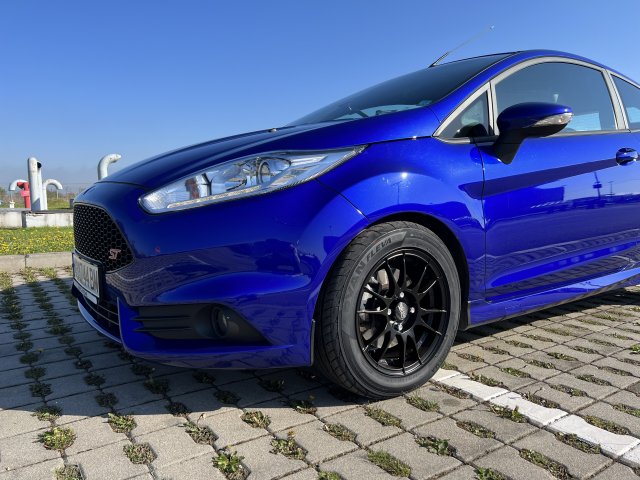

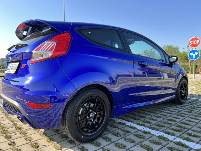

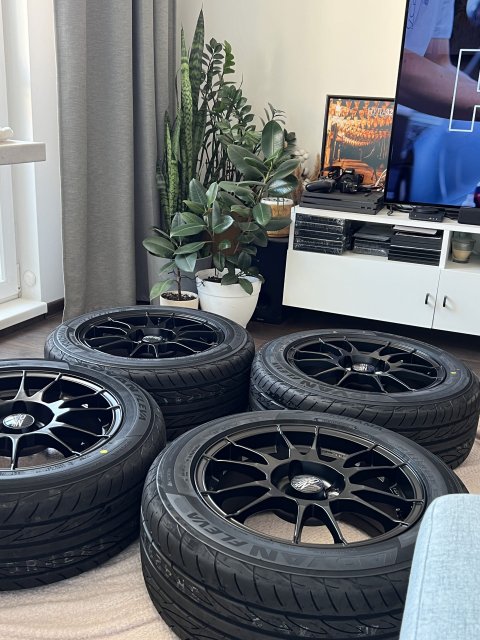

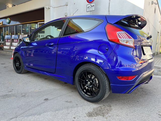

I recently picked up a fresh set of 15" OZ Ultraleggera (ET42) paired with 205/55 Yokohama Fleva V701 tires.
They spent a few days in my living room while I took the time to ceramic coat them. Honestly, I couldn’t stop staring at them—they looked sooo good. I kept sneak peeking at them so often that my GF started making fun of me that I'm checking them more often than her :D
And today... they finally made it onto the car.
As first impressions the ride quality-wise, everything I read on here was spot on—plush yet still sporty. It glides over small road imperfections, handles speed bumps with ease, and the cabin is noticeably quieter. I can actually hear more of the fun stuff now—the turbo spool, the wastegate, and that raw engine note. The rolling noise is significantly decreased.
I absolutely love how they sit:
Even after just 20 miles of city driving, the difference is undeniable. The car feels sharper, more responsive—it accelerates better, brakes better, even turns better. It just feels more alive.
If anyone’s on the fence about this upgrade—I highly recommend it.
Totally transforms the car.
I've already bought braided lines, a symposer delete + new front disks and pads.
So very soon, things will get even better, just my mechanic to return from the holidays.
Remain open to any questions.

NICE!! [twothumb]
Those are the absolutely lightest of any of the street (not full race/forged/magnesium), direct fit, 4x108 wheels out there!
Great all 'round setup if you do not need a tire which can handle extended sub 30*F temps, or any ice/snow at all. [thumb]
