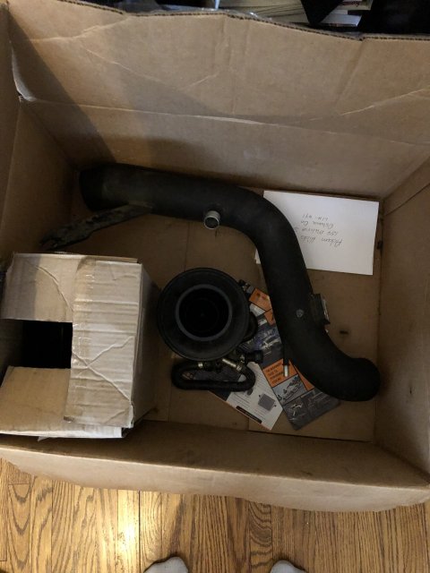

Hey Guys,
So recently I bought a second hand intake off of ebay. Upon arrival it is missing the little silicone hose to the turbo. I have gone through and contacted the seller/ebay. The seller was all mixed up about it so ebay ended up refunding me. I have also contacted Mishimoto, and they won't sell the hose separate. Does anyone have an idea what I can do with this? Is ti rendered useless without that hose? Currently in my car I have a mountune induction hose. Pics are of the whole intake setup and what is required, also what I received. Any help is welcome !
Cheers,
Adam

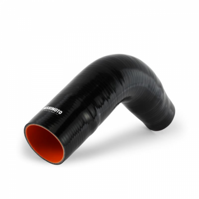

Yeah contact ATP and see if they have a Coupler that can match what you need . What are both the End dimensions? You could get a 45 Degree coupler and then get a transition coupler and use a take piping coupler to go inside the two to make them meet...If that makes sense.
Couplers
http://www.atpturbo.com/mm5/merchant.mvc?Screen=CTGY&Store_Code=tp&Category_Code=SILB
Intake Piping use inside the couplers to join them together.
https://www.spectreperformance.com/cat/air-intake-components-tubes
