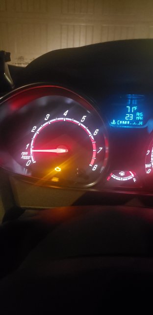

It's really fun! I've been driving all day like a maniac. Also to get a feel for it. I might even have broken something. Maintenance lights came on tonight as I was finally pulling in. Contacting the dealership...

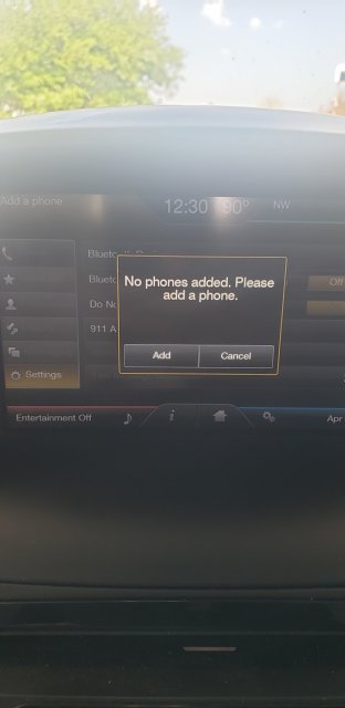

Haven't figured out connecting phone to the Bluetooth Sync system yet.
Seems I can't turn on the BT.

The maintenance light is the wrench and as everyone knows, that's typically an oil change.
That's a check engine light. Need to have the code(s) pulled. These cars are often modded and could be something related to that.
Security updates to BlueTooth may be giving older BlueTooth devices that haven't been updated, some problems.

Thanks! It definitely feels modded. Dealership is closed today, went to Autozone,
errors: misfiring 1st engine cylinder
recommended fix: getting a new injector, or coil
Waiting to have the dealership fix it tomorrow, and also give me a list of mods, hopefully. Will update.

Hey masters, Padawan here... sitting in Autonation service lot to have the dash lights checked right now.
Info sys update: I updated to Sync 3.1 Sunday. Still the same connection issue. I think my BT is not turning on. I pulled the 15A fuse in behind the glove compartment overnight and inserted Monday, still the same.
Goes BT is off, set on. I click yes and that diag box doesn't go away and acknowledge BT is now on. Then the Add phone box comes up, I click add and the same BT dialog box repeats. Picts attached.
