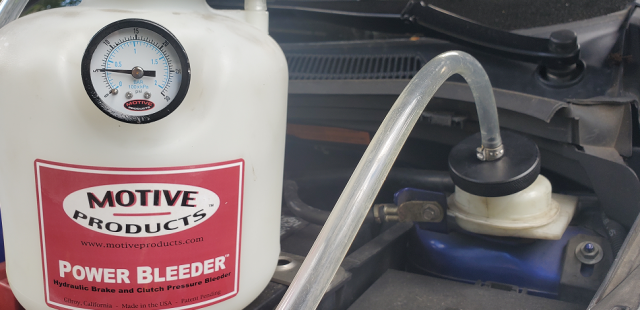

i took out my motive bleeder to test it since i will be doing brake job tomorrow
2015 fist
5 psi test, holding steady

Only 5psi? I keep it between 12 and 15, no issues on any of the 3 cars I regularly use it on, including the FiST. I believe that is what Motive recommends after telling you to check the car's manual. I couldn't find my shop manual at the time i flushed the FiST and just went with what i've done on my other two Mazdas. I should probably look now that i found it lol
like i said on my post i was only testing the power bleeder with 5 psi since i havent used it in a while, also it was to post it here, just to show you that the 1108 adapter works
and yes, when i use it, i go for 15 psi, you can even go to 20psi if you want
