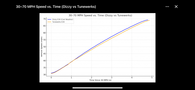

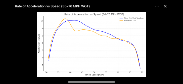

I just ran the dizzy e30 tune again in 60 degree weather (it’s tough in the summer!). In fairness to him, i am posting updated logs. As initially expected, his e30 tune (which runs 5psi more boost) is definitely faster so long as the weather is nice and cool. In hot weather they are about the same (I suppose timing does better than boost when it’s hot outside).
I was speaking with Randy and he said his OTS E30 tune is EXTREMELY conservative in order to be safe for all motors without receiving logs. He said there is a lot on the table so next I am probably going to do a custom ethanol tune with him and will report back.
Randy also made it very clear that his Mountune 93 tune was intended to be a STARTING POINT from which to optimize via logs and tweaks. He apparently used to do that for people while at Mountune, but now he’s just sold as a OTS tune without revisions. To me it seems like a worthwhile investment to let Randy dial in these tunes to your specific car. He said it’s not just a great way to increase performance, but very important to ensure that tunes are safe for your car and your gasoline.
