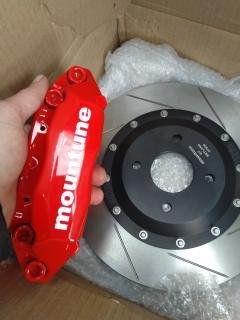

(front) 4 piston calipers with 330mm slotted rotors
Brembo / Mountune Calipers

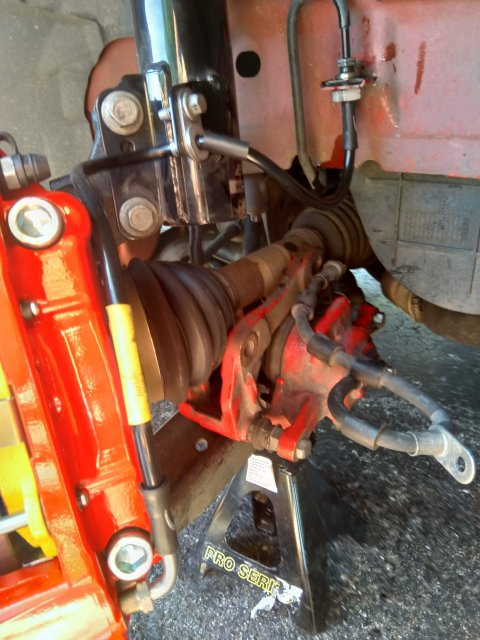

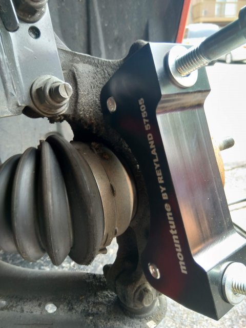

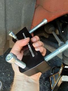

Adapter bracket

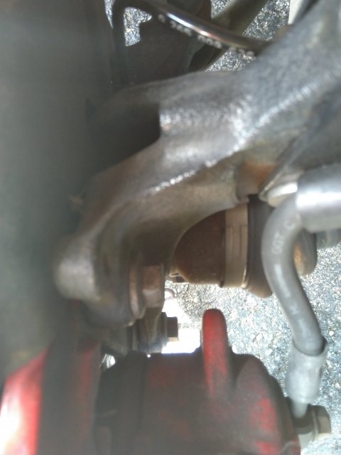

Be sure to place the screws on exactly as show due to the length of the screws and mounting points on the hub and caliper.

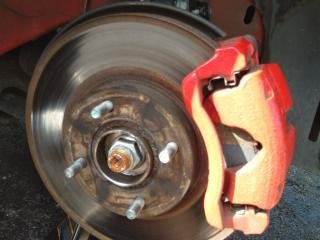

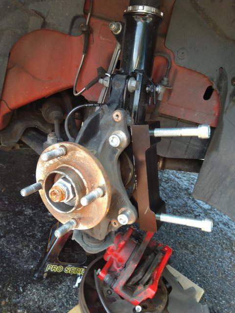

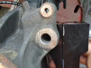

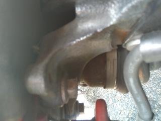

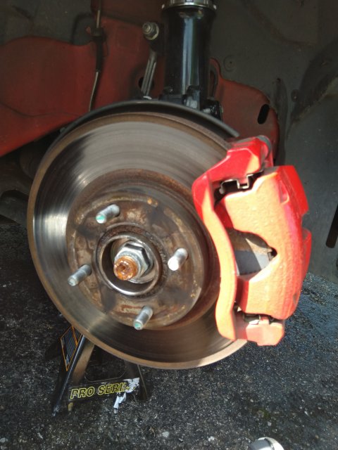

First things first take off all of that.

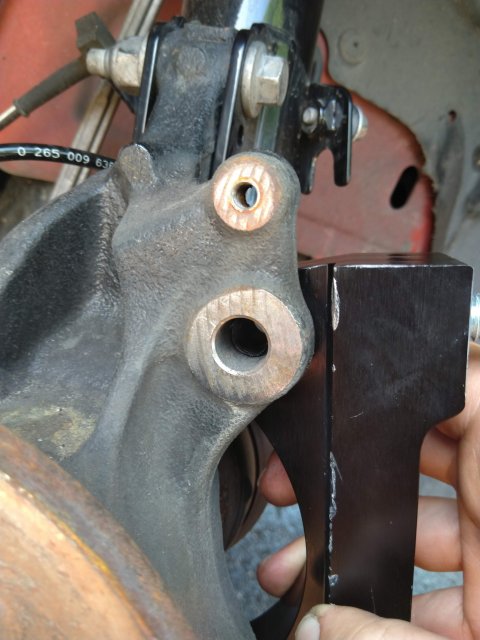

Notice how these bolts are placed because when your installing the adapter plate bracket the bolts will need to go in the opposite direction screwing themselves into the unit itself.
Do not reinstall the dust shields they just get in the way. Be sure to tighten the adapter plate bracket unit before adding the rotor.

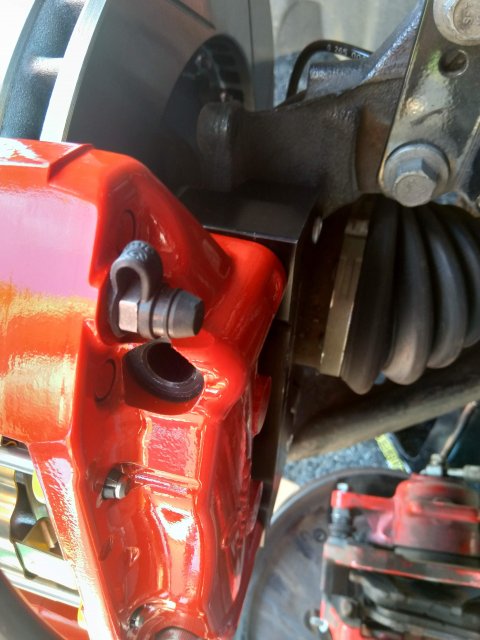

After you place the rotors in location (floating) you then install the calipers which keep the rotors in place.
Swap out the O.E. brake lines with an upgraded pair.

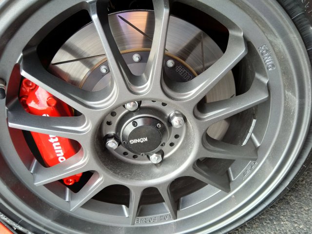

If you completed the job correctly it should look like this.

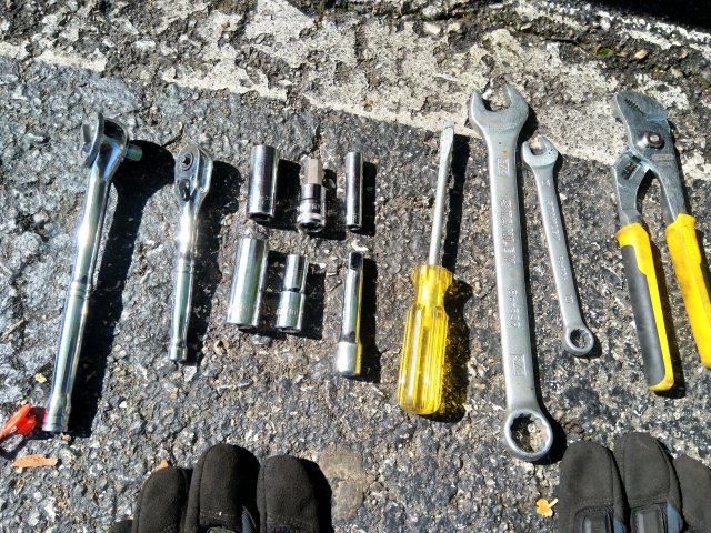

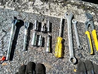

Here are the tools used on this install.
Sockets 8, 10, 13, 15 wrench 3/4, 11 and a Flathead screwdriver.

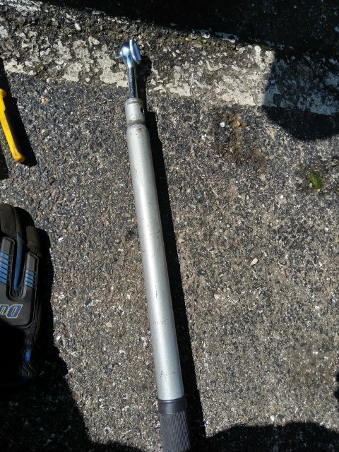

Don't forget to torque everything to O.E. spec with your trusty torque wrench.

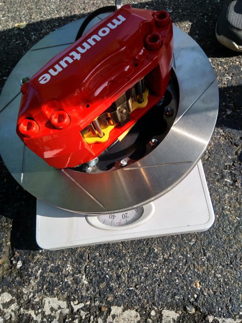

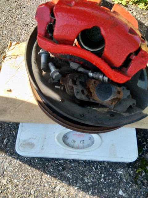

Here is the weight difference. the old setup with rotor, caliper, pads bolts and dust shield is 30lbs
The new setup with everything including hardware weighs only 28lbs
Huge upgrade in stopping power (110%) and a a loss of 2lbs on each side.
Stock wheels (rims) wont fit i would suggest going 16x9 as a minimum or you may have a problem fitting your wheels with a brake kit this large.
Spacers or longer studs maybe all you need to help.

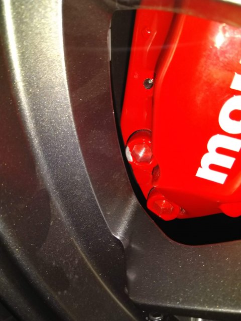

Hi there ,

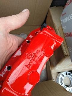

I have the same Brembo brake kit that you installed , the Brembo calipers I received are identical , rather than a right and a left , was this the case with your calipers or were the left and right slightly different for example where the bleed nipple is located.

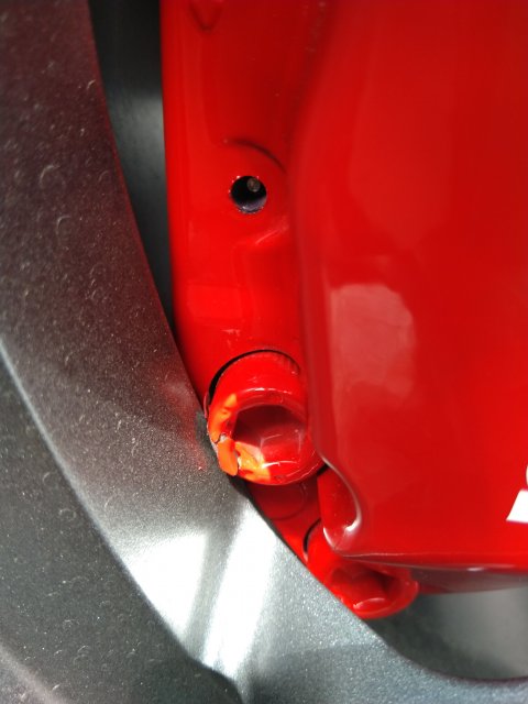

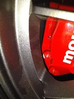

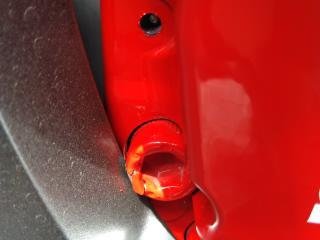

The calipers are identical the only way i knew which side goes where are these tiny arrows on the calipers, you want those facing the front of the car.

Which Konig wheels are those?

That must be one of those NEW FANDANGLED style Torque wrenches!
