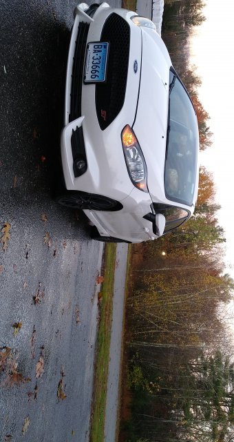

Thinking about doing negative camber on my car.
Anyone try this yet? Possibly looking to go -2 to -8
I have seen people do extended bolts and washers, but looks slightly weak. Making a camber plate is not a issue. Just asking for set-up styles or if anyone has had problems trying to do so.
