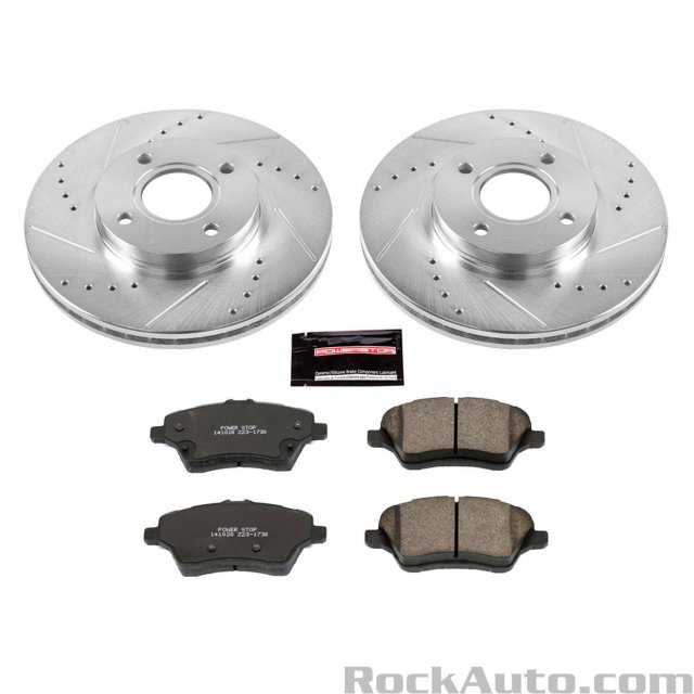

Not sure if its just how they sound, figured I'd ask. Every since I got them on the car, its making a whirring or almost... buzzing? sound. It really just sounds like its either the slots or the holes going past the pads, but its there all the time at low speed whether I'm on the brakes or not. My other cars with drilled *or* slotted rotors haven't sounded like that, but they all came with those rotors stock.
They've been on for about 120 miles.

What I ordered from rockauto was
Z23 Evolution Sport kit
pads - carbon fiber ceramic
I have the same setup and didn't notice much difference in sound from stock...granted I melted the stock pads and cooked the rotors the first time I hooned it on a track aggresively like an idiot a week after buying my used FiST and only driving 5 miles to work before tracking it, totally worth it and was an excuse to upgrade😃😃. I'm wondering if the ABS was cycled with Forscan properly during bleeding. When not done correctly it can cause some weird issues with these cars.

drilled/slotted rotors make that noise whether you're braking or not... it's little audible explosions of air heating up and going through the rotor.
I have the PowerStop slotted and drilled discs on my car and have absolutely no weird noises or any other problem with them.
I had powerstop rotors & motorcraft pads... absolute nightmare when it came to noise and dusting. my car would be entirely coated in a film of brake dust. whirring noise would be consistent.
went to centric blanks & motorcraft S pads, noticeably quieter.
That makes sense as to why I hear it more when it's hot out, now that I think of it.
And yeah, the Powerstop pads are not NEARLY as bitey as the Motorcraft or Centric, which I'm fine with since I don't track the car and they're perfectly adequate for a DD, but there's almost NO dust, it's beautiful. I'm quite pleased with them, though I may switch the pads out for a different brand when needed.
