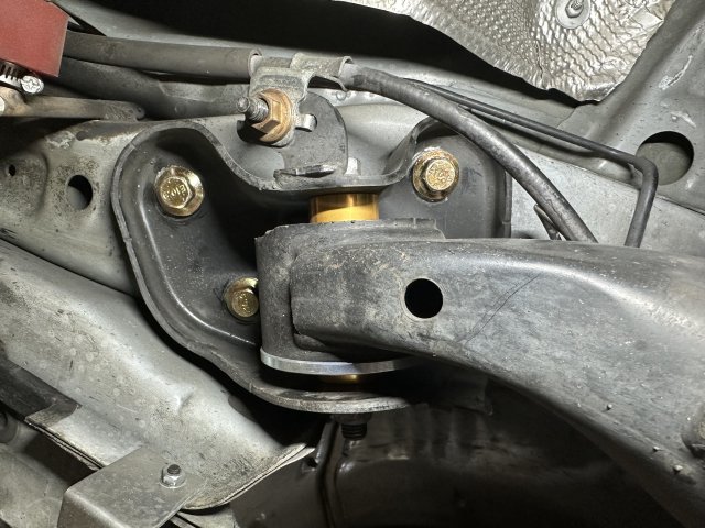

These look interesting. I have a set of spoon rigid collars for my CRZ with rear torsion beam. These seem similar (not as soft as the spoon and include a bolt upgrade).
Mine arent installed yet but the guys that have them said the rears made a bigger difference than the front as they take up a good amount of play in the mounting point of the body.

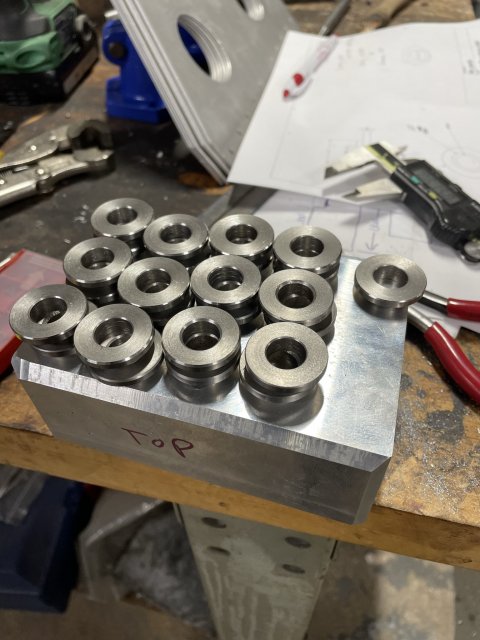

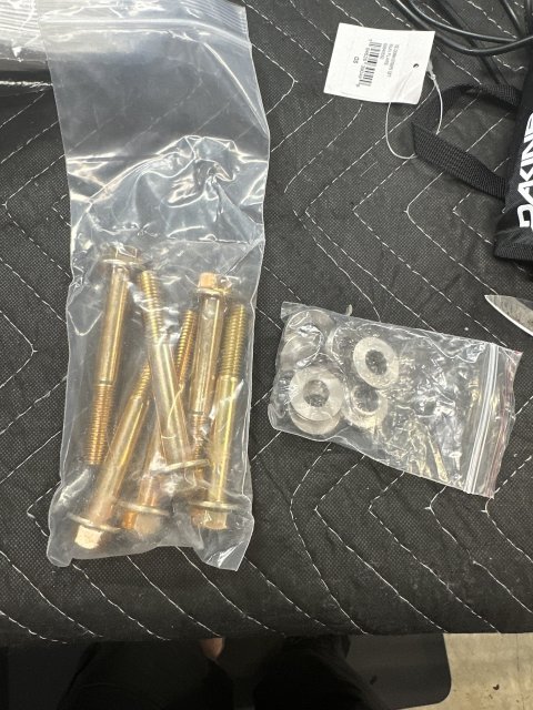

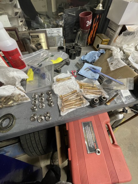

Ok, ladys, three sets with Bolts are ready to go. Fourth set will need bolts. Have to order some. PM for your sets.
Will be wanting some feedback on fitment across your various cars. Just to see if dimensions need to be tweaked for future sets. I think I am good based on where I am currently on my car.
