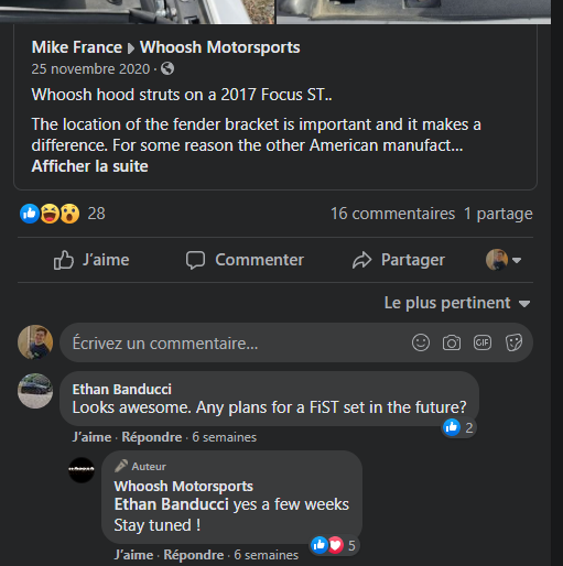

Isn't Whoosh working on a similar product? It might take a long time before we have the version to buy though (looking at you, Whoos cat back exhaust :p)
@ron@whoosh
I checked Whoosh website but did not see a Fiesta fitment.
