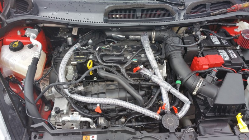

As for the picture in post #177.
That really does nothing.
Now you are not sucking air through/across the valve cover but just venting through that bypass filter.
Where is the vacuum that makes the catch can work?
Having the inlet air tube connected to its normal location on the main intake pipe it is connected out through the air filter so that fresh air can be drawn in to purge the vapors from the valve cover and crankcase.

I do however think if you wanted one OCC the pic on post 177 if you take the filter off and run it to the air intake in front of the turbo it would wark and keep most stuff off the valve stems but it would impinge on the turbo blading and could cause erosion over time. Like I have said in the cold north here I was getting more water than oil in me OCC over winter so had to check it everyday to get a feel for it..

Since I have an Elite Engineering can already modified and in use I could easily swap it to #1 line, it traps quite a bit of oil with just a baffle and mess filter, I was going to add a bronze element to it as well which I an still do.
I have the top Mishimoto can to install on Line 1 so then I would have a dual system but not really add that much weight as the Elite is smaller, etc and I have plenty of room for it.
The EE can does work well, billet, blue anodized aluminum, the new can is black with blue trim, I am going to look at the MM smaller cans for line #2 so it all matches better as I could easily sell the EE can and with so little oil in the #2 line a simpler can is likely all I would need.
Pic before the DIY Mishimoto radiator install.
NOTE: I am not a fan of VTA, just like I ran a big cat on my original DP, a bit to big it seemed, I will we testing one on the EFR build once done.
