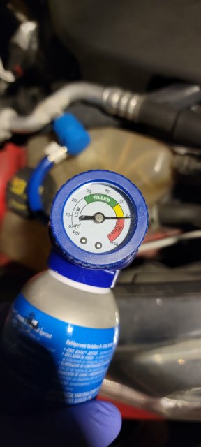

Just moved to Phoenix and eff me it's hot. The AC in my 16 has been working but not really all that well so I figured it was time for a recharge.
Got the kit and hooked ut up to the low side. It was reading 40psi and I wanted to get it just north of 50 as it's currently 108 at 9pm.
I had the trigger down and would let it go a few seconds and check. It wasn't really moving from 40. Press a few seconds, read, 40. Press, read, 40. Repeat and repeat and repeat until press, read, oh shit, almost 60. I could hear the idle change slightly and the ac in the car is cool but not cold. It was like it wasn't taking anything until it took too much all at once.
The pressure will drop to about 55 and then go back up and hang out right at 60.
Did I fuck it up or is there a way to purge a couple lbs of pressure?

Welp, fixed it. Hooked the hose back on and removed the bottle of refrigerant. Covered the end with a towel and hit the trigger to release some pressure. Dropped it back down to where it's supposed to be and it's blowing ice cold.
Idk if it was a bad fitting for the gauge where it wasn't reading properly or what but that was scarier than it was supposed to be. If you're doing this, take your time and make sure you're getting a good reading before you overfill.
