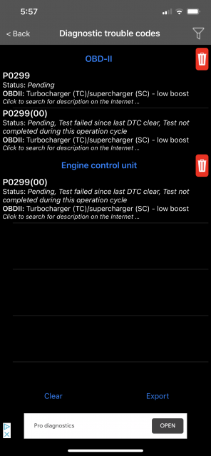

Ok .. used a OBD ii 2 reader on car because it seems to run in a “ granny “ mode since ECU replacement.... i hear turbo spool but no PSSH sound .
NO DASH FAULT LIGHT
NO WRENCH LIGHT
Idles under 1000 rpm - stable
Rev up and release - idle normalizes
Driving car - seems fairly normal but no real pull in 3rd. Seems like im in some kind of valet mode. I heard ECU needs to re-learn driving habits to setup - . But will double check intercooler hoses and such ( maybe boost leak ? ) or ?
Not sure where to start . There is NO TUNE installed. Should I disconnect neg. and let ecu clear ? Or where else to look.
Help

I'll have my money on a boost hose leak or Boost hose blown off on the Hotside * That is where i would start! Good and update when problem has been resolved!

Well , seems like I corrected issue after DOUBLE up on clamps ( both sides ) .
Boost is back , but will change charge pipes ( ordered ) ... noticed the OEM are very soft so they will be swapped out. Used T bar clamps .
