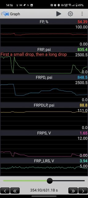

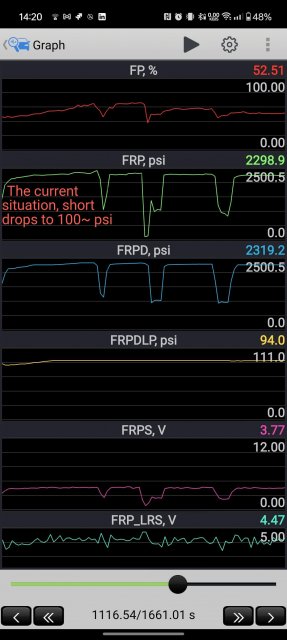

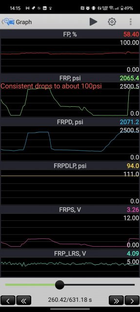

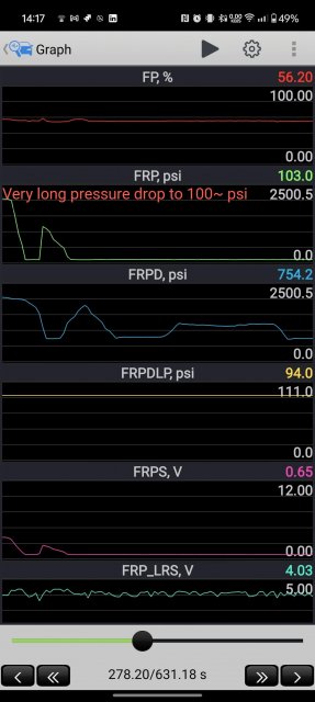

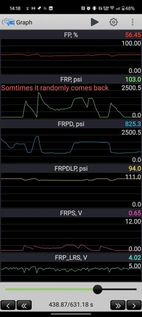

I have multiple forscan recordings available in which the issue is clearly visible, here are some screenshots:
- Red = Fuel pump duty cycle.
- Green = High-pressure fuel rail pressure actual.
- Blue = High-pressure fuel rail pressure desired.
- Yellow = Low-pressure fuel rail desired pressure.
- Pink = High-pressure fuel rail pressure sensor voltage.
- Cyan = Low-pressure fuel rail pressure sensor voltage.
I’m sort of at a loss of what the issue could be since I've literally replaced every component in the fuel system I can think of. The only thing I haven't looked into yet is an electrical issue, but I have no idea how I would debug this. I would really appreciate any suggestions or ideas. If you've encountered a similar issue, your insights would be invaluable.
