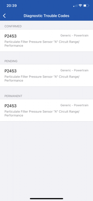

Hi. I have a 2018 petrol Fiesta ST3, and my engine management light has come on. My diagnostic machine is telling me it is my particulate filter (see photo).
Any ideas what I can do to fix this? Reading some articles this shouldn’t need clearing or replacing, so does this mean it is faulty or a sensor issue maybe?
I have just been doing 70mph on the road and it didn’t clear it like it would in a diesel car.
Any help/advice much appreciated!
I've been having this problem too! Mechanic suggested getting some redex and seeing if that cleans out the system but I haven't had any luck. Did you get to the bottom of the problem for your car?
