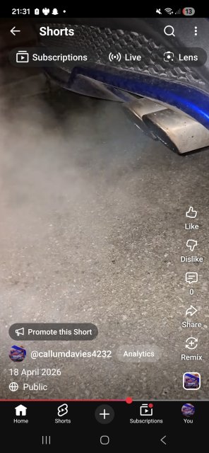

Please tell me if this is blue smoke
SteveS
#12296
1,710
2,074
I can't really say, especially given that the video is shot with some kind of artificial light in the dark.
#3304
11,980
8,414
Its condensation from the exhaust/ engine running * quit worrying and drive the car.
#34799
18
22
It appears to just be condensation. The blue tinge could be from the lighting or as part of a slight reflection from the blue paint on the vehicle. How many miles on the vehicle/engine? If you are not seeing the oil level go down between services, you are probably fine.
#6990
103
69
does it smell strongly? looks to be just water vapor, which is a natural thing from a cold start. cold exhaust pipe, hot air, moisture condenses. All normal.
