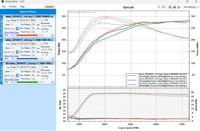

Big grain of salt, but virtual dyno is generally around the 280WHP mark. I use the default frontal area and drag settings and a rough estimates for weight, and my tire diameter is different than stock. So, don't fully take the numbers at face value, because I just use virtual dyno to compare runs and make sure everything looks ok/happy. I'll drop in a snip of the three latest iterations. Note that I have and uprated HPFP and +30% injectors which helps keep the AFR rock solid at high RPM. I made roughly the same power before the fueling upgrades, but in the high RPM range AFR would lean out to ~12.2-12.3 which isn't super dangerous, but also not ideal.
As far as running high(er) octane fuel, I brought it up to Jason and he said there isn't a ton to be gained and ethanol is the best bang for you buck.
Trust me if I could find it I would use it, I think the closest station is like 60 miles😢 though there is a Torco dealer down the street from me, I also don't have the storage space for fuel😭😭😭

Do you have any pulls in fourth? I usually do my logging with 4 gear as it's the closest to 1-1
Haven't done a log in 4th as my usual data logging roads in... Mexico... aren't great for that type of speed (3rd is already pushing it). With my tire size and redline I max out ~125mph in 4th. I may be able to get one at some point.
