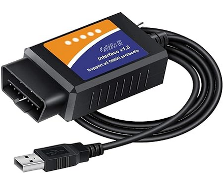

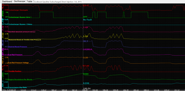

  • Borrowed a forscan scanner and have been checking various sensors and readings (attached)an

Alright guys, so I took the first, simplest approach of changing the wastegate actuator solenoid (bit of a pain in the ass tbh). Went to a couple of mechanics who both suggested I change the catalytic converter, no mention or hope in the wastegate.

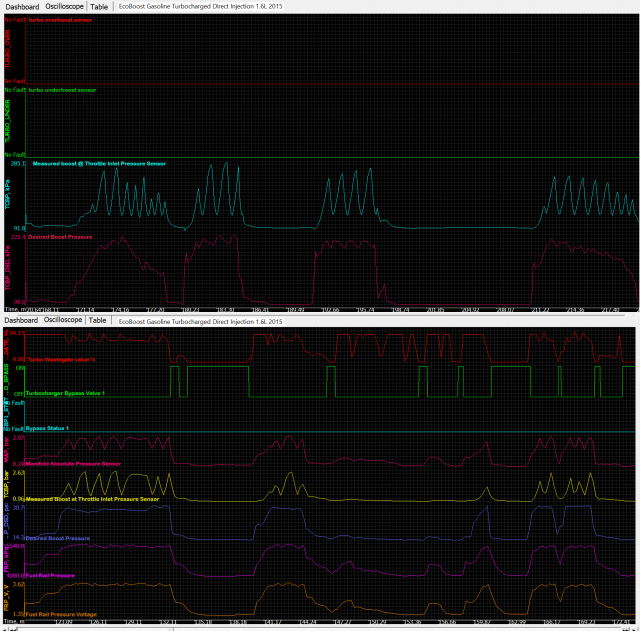

Well it turns out IT WAS the wastegate solenoid. I went OEM, did a couple of runs with forscan and then reset my transmission adaptations and did more testing, results attached below.

Without my laptop/forscan I was only detecting this at around 2000-3500 rpm and mostly on hills, basically when the turbo kicks in and it's tuning for torque I assume. According to the data it is clear this stuttering happened all the way through the revs. What puzzles me and puzzled the ford tech (I visited the head tech for an impromptu brain picking) was the lack of codes. He thought the catalytic could be partially disconnected internally, leading to it coming detached under heavy acceleration.
