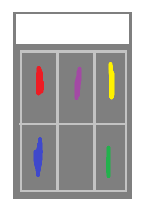

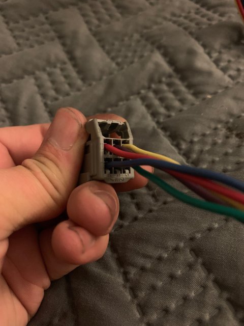

2) Instead of putting the wires in as you would for the Spec-D use this diagram:
It should look like this on the backside

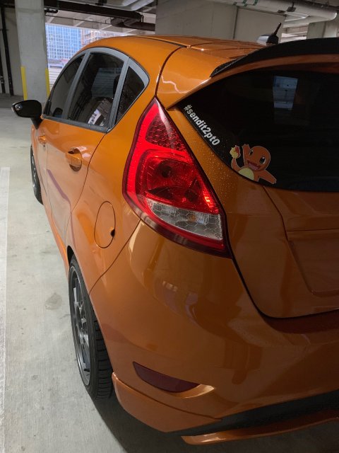

6) Take pictures. Here's mine:
