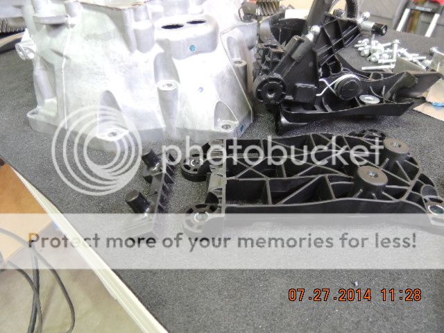

Stock two part shifter mount, sorry for the blurry photo.
Bottom section.

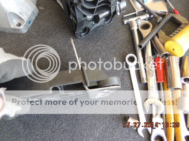

Back section removed, slot to be cut in the middle brace area, I was going to reuse the part but realized it was going to be a compromise so the job became much bigger at that point.

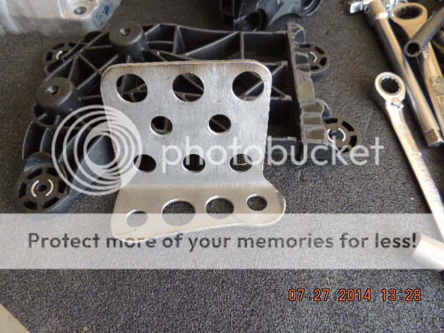

3/16" steel insert I made to raise the top section.
Inserted, I will add washers to the bottom on the front and back to raise the whole mount as far as I can on the stock studs until I get the long nuts I have on order.

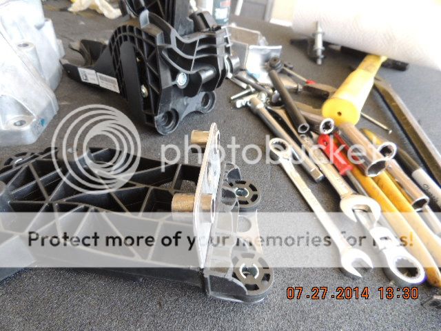

The only "tubing I could find the right diameter was a craftsman 12mm long socket, lucky I had three so one was sacrificed for this ST.
3 corner welded, ground and then not shown but the front stock screws were used through the socket into the plastic on the other side, very snug and strong connection.
Angled stand offsets made to compensate for moving the top mount forward 3/16" and lifted at the front to bring the shifter close to the driver, braced with welded in rod.
Bolted together, tested on several axis and it is very solid, more so than stock yet it still has the rubber bushings so as not to transmit to much harshness.
