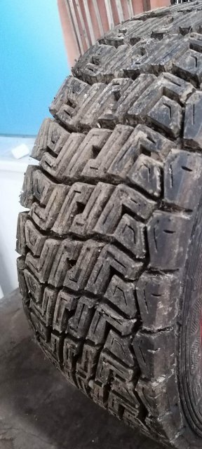

My suspension setup is a little higher than stock fiesta height. I can get cheap 15 inch rally tires with dimensions 195/50. Before that I drove 16 inch 195/50 tires BUT without reinforced sidewalls (so essentially street tires) and ride hide was ok on mixed gravel/ashphalt track! So if theoretically radius is decreased by 0.5 inch: will ride height rly be affected by 0.5 inch or will the the stiffer sidewalls result in less lowering during actual driving on gravel?

WHO makes 195/50-15 GRAVEL tires?!?! [???:)] [???:)]
(Or are these heavily siped/treaded tarmac tires you are going to use on gravel/mixed surface autocrosses, what we call SCCA Rallycross here in the states??)
I always try to buy XL rated street tires, especially the ones I am going to use for working on rallies, or winter driving, as even though they lack those crazy strong, almost indestructible ribbed sidewalls of real gravel donuts, they are much stronger sidewalls than just regular old SL rated tires. [wink]
The car's subframes/control arms/unibody will sit (at static height) yes about a half inch lower overall, all else being the same (suspension, tire pressure, etc.).

I also found 185/65, this is what i will buy, I cannot rly go 1/2 inch lower, i was already at the limit before. The brand is german I think: indy sport, they make a lot of different sizes of what I call gravel tires and yes, people use them here for national rallycross (not what you call scaa rallycross i think but mixed surface or pure gravel tracks with "joker" laps) and national stage rally but as a low budget option, i think some of them are retreaded.

Oh, OK so the 195/50-15s are actual WORLD/Euro Rallycross tread pattern/construction style donuts, like the ones Cooper makes, and not ribbed sidewall, narrower, gravel rally type rubber (albeit retreads), correct?

i am not rly familiar with the cooper tires but here is a picture of the 195/50 indy sports profile

I cannot see the full sidewall in that pic, but those are 195/50s?
It is amazing that anyone built (even on a retread!) a 50 series sidewall, but FULL gravel rally tread pattern tire, replete with 3 rib reinforced sidewalls (I did not think that they even existed, anywhere!).
But, COOL! [thumb] [cool]

yes, 195/50, there are many other sizes of exactly this tire, like 155/70R13 or even 225/45R17!
