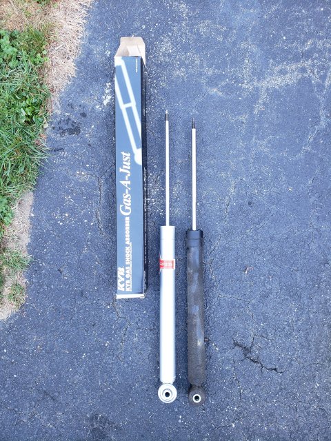

Finally got some rear shocks! I ended up deciding to just save money and ordered Bilstein B4s. After Months of backorder I canceled the B4S and went completely wild card. I got KYB "Gas-A -Justs" they are supposed to fit a Mazda 2, LOL. For $50 each they are a high pressure monotube shock that fits. From what I can tell it rides smoother and the rear end feels tighter on corners. Down fall is that the rear wheel gap is larger, probably only because the old ones wouldn't even return when compressed.
Not 100% sure I would recommend these but I liked trying something new.
Thanks for all the recommendations
