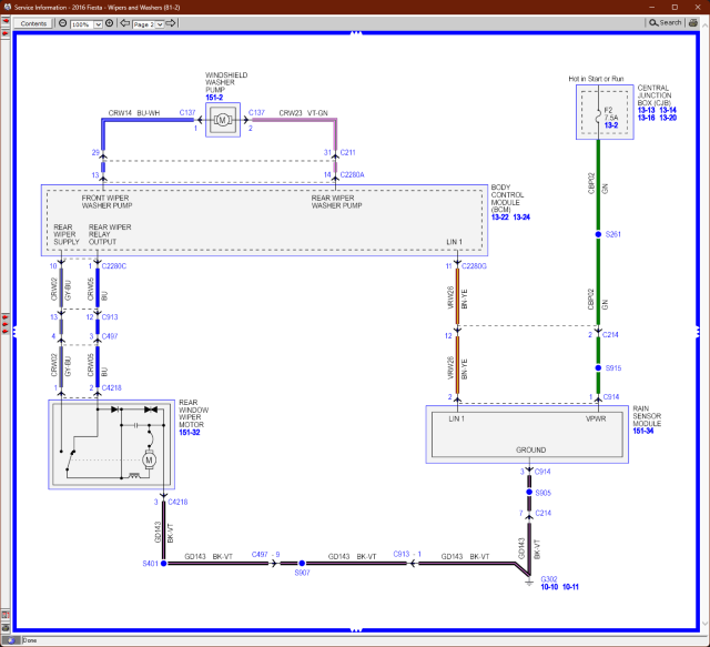

In addition to what @anxiouz mentioned, check for codes. Confirm whether power is leaving the BCM. Confirm whether it is reaching the wiper motor. (more convenient to check at connector points) Check for shared ground point. "Voltage drop testing" while a circuit is fully loaded can help you identify the existence of connection(s) with insufficient load. You can verify signaling by poking a straight-pin through wiring and connecting to volt meter.

NOTE: I seriously doubt we have the rain sensing module cause Ford cheaped out on features for us 'meriguns.
