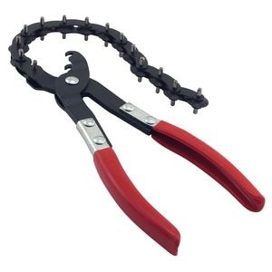

I just installed my CBE a few days ago.
If you want a clean cut, use an exhaust pipe cutter. Takes a bit more time than a sawzall, but a way cleaner cut.
Took me about 5 mins and I was taking my sweet time.
