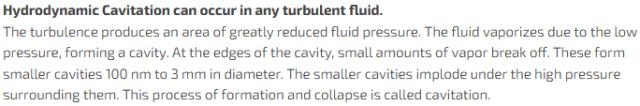

Manual specifies low-viscosity brake fluid. As far as I can tell it's thinner than the traditional stuff..
A thinner fluid might be more resistant to cavitation when the ABS pumps activate.
This is why I want to stick with a DOT 4 LV fluid, albeit the very best, with the highest boiling points, of that type.
I do not open track, or autocross my car, so I do not need the 650*F DRY boiling point, DOT 4 RACING fluids at all.
The top tier DOT 4 LV I am going to use has a WET boiling point not much below all of those (even the best) DOT 4 RACING fluids, which is much more important for the street, and the longevity of the fluid if one is not going to be bleeding the system, or totally flushing it out every week.

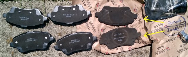

Two other details.
1) Same as directional tires have an 'inside' and 'outside', your pads may have an 'inside' and an 'outside'. Make sure you pay attention when removing and reinstalling your pads.
2) Make sure your caliper slide mounts aren't locking. You may be able to move them during inspection, but they may seize, heating up during use.
