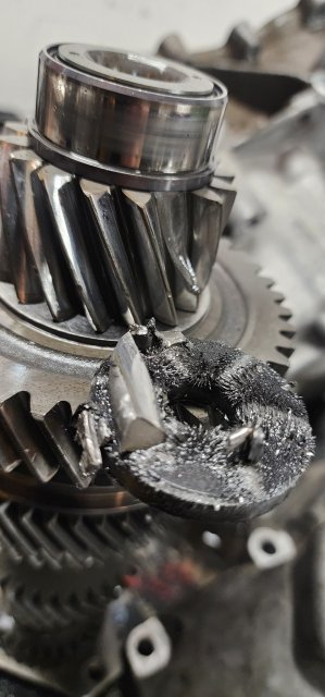

Back in early 2025 after getting the car to 26k miles, the reverse gear went out. Originally I only planned to get the transmission worked on by Colby Clarke, but then again got distracted and began a 3rd round of modifications with a bunch of stuff not related to the transmission at all. Not being really happy with the oem recaros, I went with JDM Recaro SR-7 reclinable seats. I got an S280 thankfully before the price spiked, got Hella Euro headlights. Suspension wise upgraded to DNA adjustable front arms and Spoon rigid collars (loved these on my other cars). Threw on a Coolerworx shifter and regret badly it wasn't one of the first mods I did.

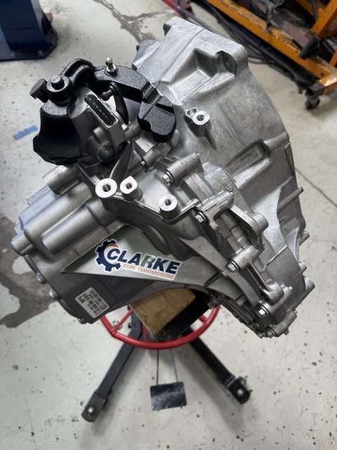

-Colby Clarke rebuilt transmission using new oem core
(oem transmission had reverse gear damage at 26k miles)
-Syncrotech carbon syncros assembled by Colby Clarke
-full wpc treated gears
