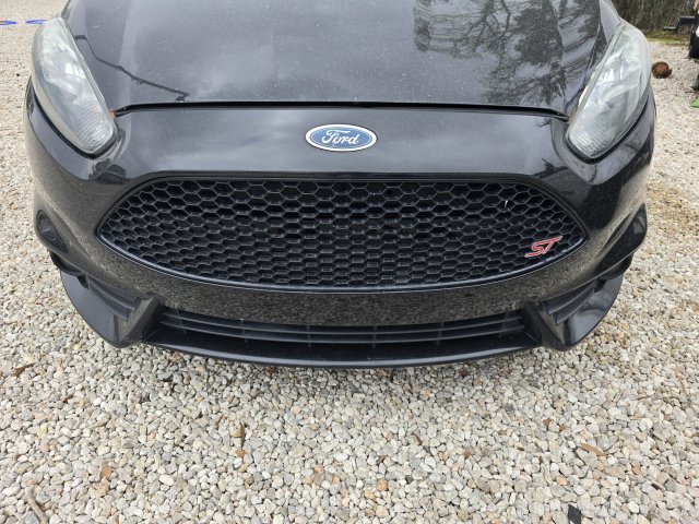

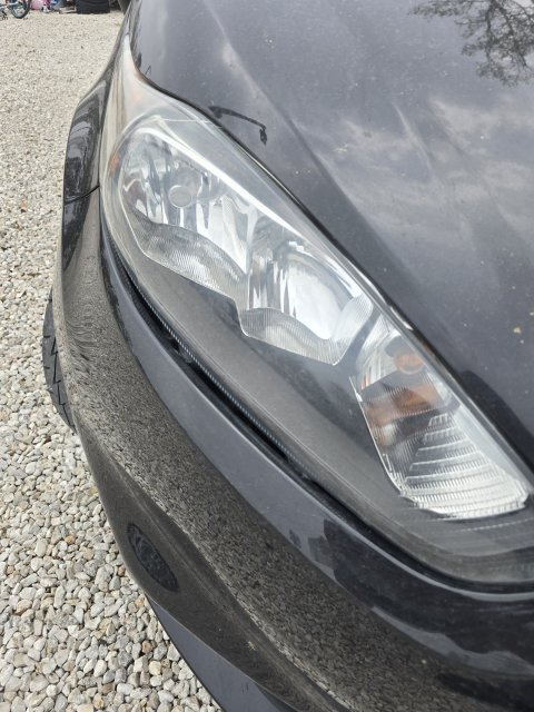

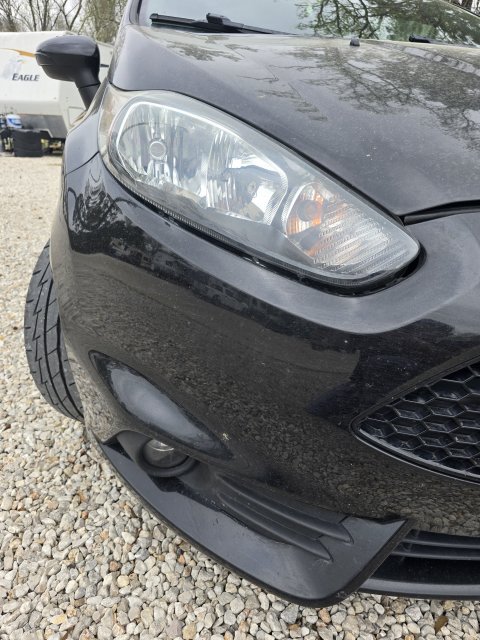

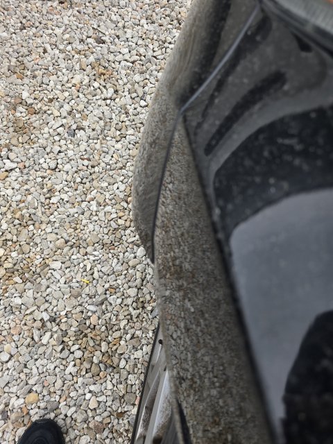

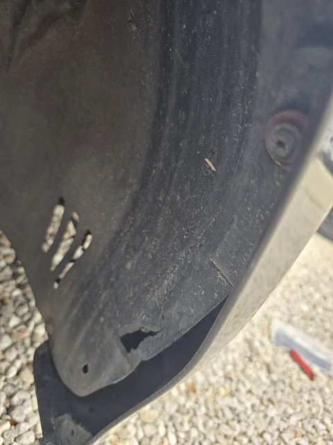

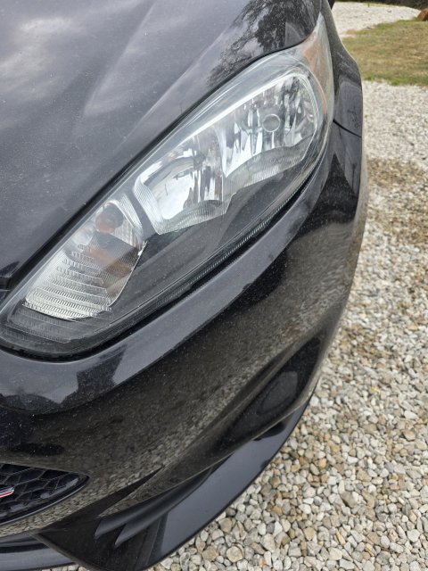

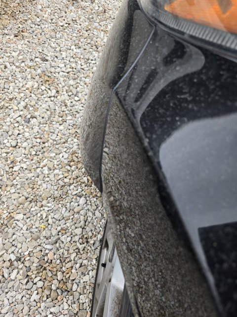

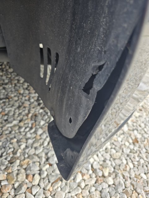

Hi y'all! Car's been in several accidents before I bought it and this was the fitment of the bumper cover. I thought at first it was saggy due to the front support clips being broken/bent(1/2 pics) but after trying to use the zip tie method on the two top squares it feels like the bumper is just off or something as it still bows on the fender sides? Would like some input before I end up removing the entire bumper cover. Could this be because they used an aftermarket bumper in the accident? I've been considering getting a used bumper off a stock car once I get my intercooler. It just seems the bumpers dimensions aren't right especially when I see how it lines up with the fender liners(although they're broken from the accident as well) Thanks y'all.

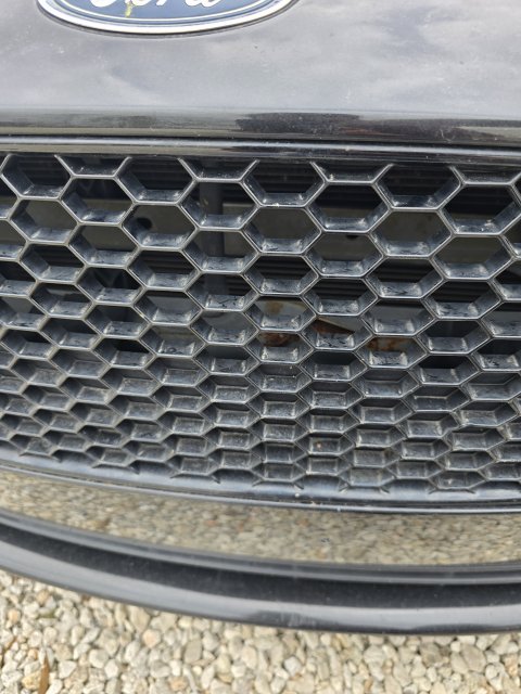

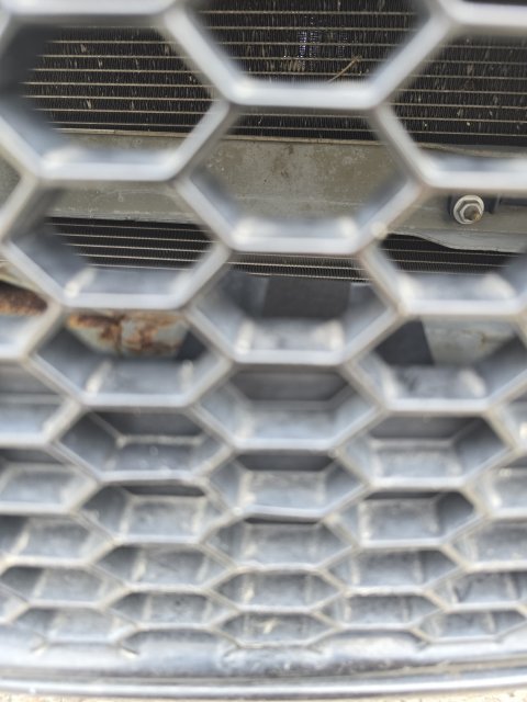

Isn't the crashbar supposed to be the same color as the car? In this case black? I just realized it's grey...

If I had to guess I'd say the car was never actually repaired after a collision(s)
I would say that someone may have backed into it while parked but the wheel well cover suggests a more dramatic event.
Doesn't take much to at all to push the bumper cover in and bellow the sides a little.
Crash bar color is normal.

This car still has the factory intercooler, correct?
Sometimes, some of the larger 'OEM fit' ICs do not allow the owner to reinstall the required bracket, or that bracket disintegrates from age/wear/weather & temp extremes exposure.
That can also cause the gaps/sagging around the hood and headlight juctions, but usually not at the front of the wheel wells like you are experiencing.
