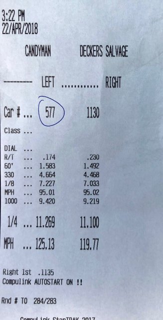

When I dragged motorcycles launch and 60ft had a big effect on trap speed. I guess if you're carrying more speed at the 60 and 330 it will translate to a higher trap. If theoretically you could put all the power down at launch you would be near or at the top of 2nd or well into 3rd by the 330. If you've got great top end you can pick up almost 30mph from the 1/8th to the 1/4. Here's a slip from my S5. It had a strong back half. If my 60 sucked I would trap 2-3 mph lower.
