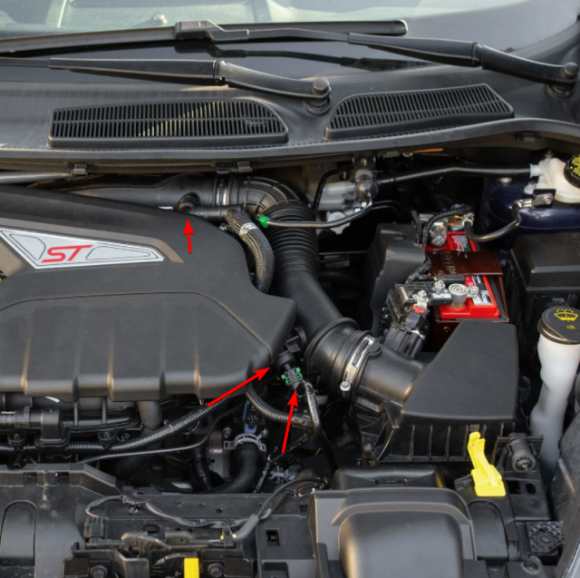

It continues to bounce between 11-12 and 16-17 until it eventally settles back to 14.7. When I was replacing the fuel sensor, I had to remove the beginning of the intake, the soft plastic part between the airbox, and the hard tube. I replaced the two "vacuum?" hoses (the ones with the green tabs), and the other hose. Noted with the red arrows in this photo.
At this point, the only thing I can think of is the upstream o2 sensor? I have had a p0133 code for a long while now, and last time the car was in for service, they mentioned something about a spacer being on the front o2 sensor, however the car never had issues like this until now. I am not too sure where to begin with diagnostics, as I do not want to hurt my car by running it. I have a spare o2 sensor that I had bought when the car started having the stalling issue, as it was a fairly cheap part on RockAuto(I got the motorcraft dy1285), so I figured I would throw that in tomorrow morning, and remove the spacer they were referring to.

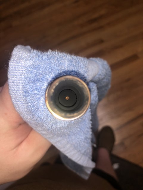

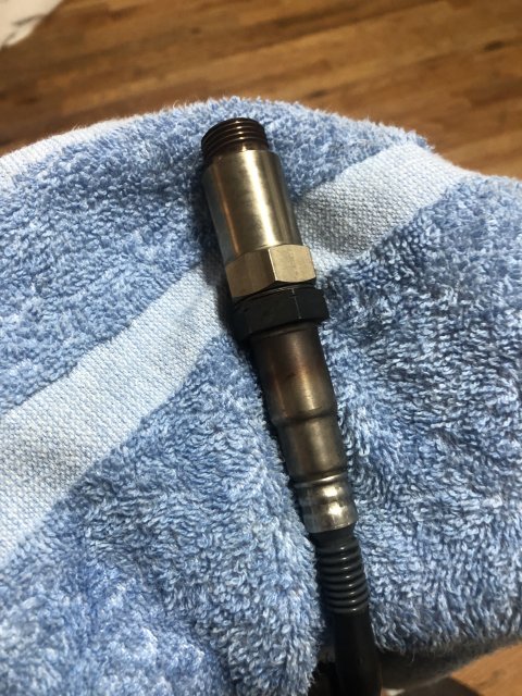

I pulled the upstream o2 sensor, and like Ford had mentioned, it had a defouler/spacer on it. This was probably a large part of my actual issue. Car seemed to run fine, and pull hard. Went ahead and did an oil change today, as I was close to the 4k mark anyways(ive read something about these cars doing 10k intervals???)
Here's some pictures of the upstream o2 sensor. Definitely got its butt kicked the past 15k miles or so. Im assuming the car ran ungodly rich for a while, so its making me start thinking I may need to get my injectors cleaned and do some plugs...
Either way, car seems to run a bit better today. Going to drive it to get some food, and see how it does. Also going to go ahead and log some data and send it over to my tuner, and see if the tune is off because of this issue.
Incase anyone was wondering about that defouler, what I believe happened was when my turbo was replaced, Ford removed the downpipe and o2 sensors. When it was put back together they must have put the defouler on the front. Either way, I can live with the P0420 code when I am running the stock tune. Bit of electrical tape always does the job.
