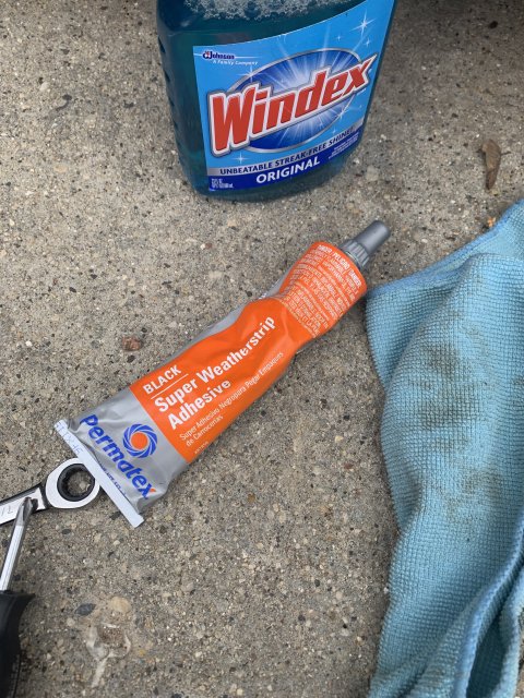

I fixed mine with this... has worked wonderful. Just get creative with how to hold pressure against the skirt while it cures. I believe I leaned a 2x4 propped against it with like a cinderblock leaning against the 2x4 for pressure. You might be able to clamp it... I tried but didn’t have the right clamps or something. I kinda forget because it was a while ago. It works awesome though. The glue is rubberized like the factory glue they used there and it is black. Also fixed my mud flap gaps with this and my roof rubber trim.

I fixed mine with this... has worked wonderful. Just get creative with how to hold pressure against the skirt while it cures. I believe I leaned a 2x4 propped against it with like a cinderblock leaning against the 2x4 for pressure. You might be able to clamp it... I tried but didn’t have the right clamps or something. I kinda forget because it was a while ago. It works awesome though. The glue is rubberized like the factory glue they used there and it is black. Also fixed my mid flap gap with this and my roof rubber trim.
Great tip. Thanks. I’ll give it a go ASAP!
