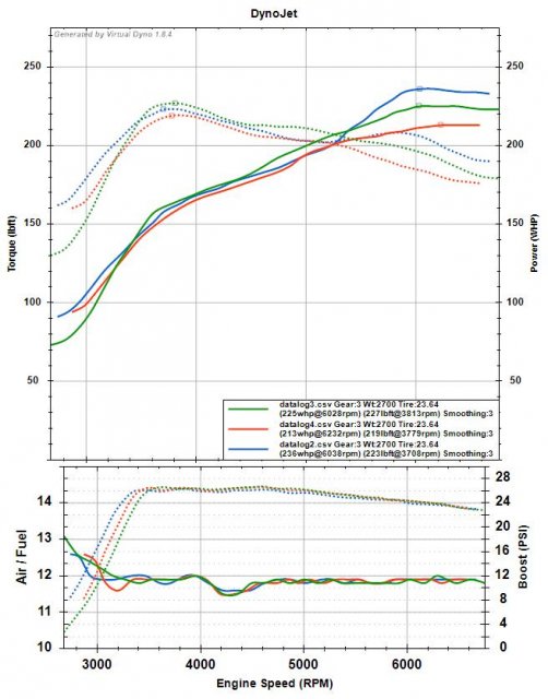

So it appears there is something wrong with my car. I feel like i should be making WAY more horse power or maybe im wrong.

IDK 215whp
238:cautious: like wtf i see everyone else making around 290-300 on 91 (V-dyno) with the same mods
Here are 3rd gear pulls
6,367
6,000
did you set your wastegate preload? it should be 14lbs or more at base tune. I get 284whp on 91 octane with stock fuel and 290-300 on E30 with my s280 mods very similar to yours except I am running a Mountune Sportcat catted dp and no extra fueling .Honestly you could run a stock downpipe with these numbers it would not change it. Also how much boost are you pulling. I pull close to 27lbs I pulled 29 during initial tuning but Adam@Tuneplus dialed it back a bit for safety on the top end.

Does vdyno read desired or actual psi? I'd load up some parameters and data log, put it into datazap.me and see if you can sort it out.

Also vdyno is usually 4th since that's closest to 1:1 right?
Yes, 4th gear is recommended for dyno pulls for the exact reason you stated. If anything, a 3rd gear pull would show higher numbers due to the gear ratio.
OP, you are losing boost towards the top end for some reason. The S280 should be holding boost all the way to redline. Something is definitely off with your car or tune.
Im new to all this and have no idea what to look for, it does have all the parameters logged, or at least the ones dizzy looks at. I wonder why he didn't say anything

I went 4 turns, 4mm and verified using air compressor. Its hard to to know what's going on the car without logs. The boost curve looks to be comparable to most cars. The boost tapers more than I would prefer, but it might be tapered on purpose because knock is killing your timing/boost. It looks like you might not have much timing in the tune. I noticed you don't have colder plugs listed in your modlist. How many miles are on the car? You might have too much carbon in you combustion chamber causing hot spots/knock. Also check you your intercooler pipes for oil. If you are blowing some oil into the pipes it will lower your octane. I haven't seen too many peeps getting 290-300whp with 91 octane. Some people were getting around that with 93. I was only getting about 250 with 93 and figured out I was having oil issues, so I got a Damond Catchcan to stop that and started pulling cleaner(less timing reduction/knock). It shot up to 270-280.

I would send dizzy another email asking him why the numbers look so bad. If that doesn't work send your logs to another tuner and see what they say. You could go back through and check all your work and make sure there no leaks anywhere.

Oh wow i believe i have 2 less turns then you. My tunner claimed on my last logs where we left off that i was making 290-280 but we left off on E40 lol not 91. shouldn't i be making like 320 340 on e40 with my mods? Anyway im going to send him a log today or soon and hes gonna get back to me. I had hot spots on my spark plugs. Through the entire tune (e40 & 91) i was running a .026 gap just barely gapped them to .024 which is what he suggested to me. After i asked him.
My car has 77,000 miles and i do have 1 step colders. There is actually a little oil in the piping.
My spark plugs were gapped to .026 and not at .024 like dizzy suggested. But he suggested that to me only when i asked him after the tuning process on a different occasion. I had no idea i had to re gap. Must not be that urgent because he didn't ever check with during the process.
