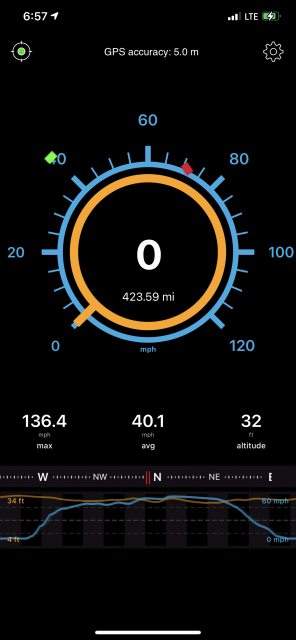

My speedometer reads about 20% off. When it says 70 mph, my GPS says 84. Interestingly, the odometer is accurate. I've checked it with two iPhone apps, and my other vehicle. It is spot on in my F150 Lightning. Anyone having these issues? The other day I accelerated a bit on the Interstate, and the Speed Box app read 136.4, when my speedo said around 114.

This is going to sound like a dumb question, but you verified this without the phone plugged into the car via USB?
There is, or was, an odd behavior with Sync + CarPlay showing higher MPH through CarPlay than what's displayed. GPS apps would show well above the indicated speed on the car. Unplug the phone and it worked fine.
I use Android Auto and have not experienced this issue but when my girlfriend would plug in her iPhone speeds were way off. Unplug her iPhone and the speeds line up.
Otherwise, it's a speedo calibration issue. As noted above, verify overall tire diameter matches the original size or you'll need to calibrate the speedometer.
