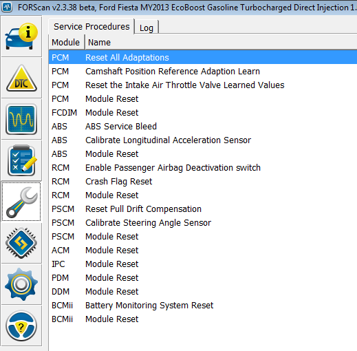

mrmrva
New Member
Serbia
Hey @Dahveed what year is/was your Fiesta? Can you check my screenshot and let me know which option did you use for PCM?
