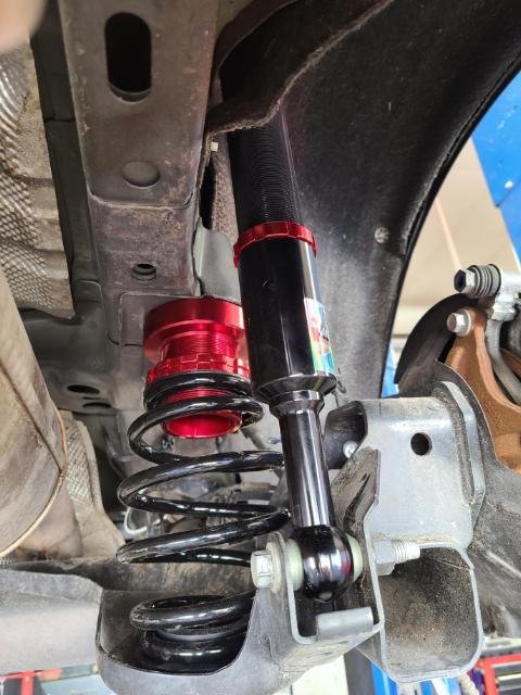

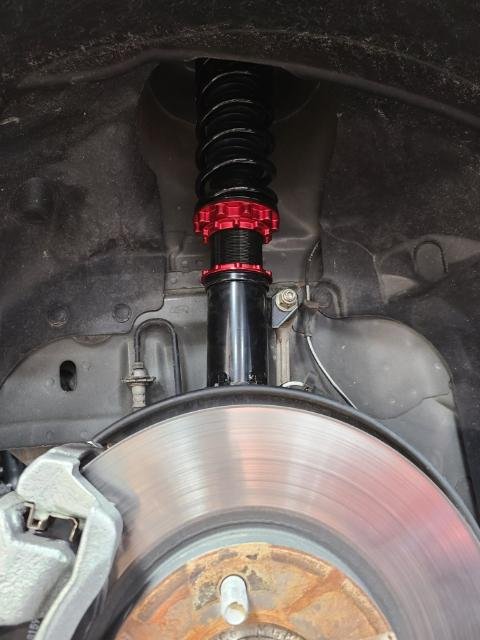

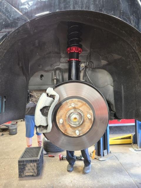

I spent most of yesterday installing MeisterR coilovers.
They sit nice they seem to ride well now. I may increase the dampening a little bit sacrificing body roll.
My questions to those with MeisterR @MeisterR I hear a Knock coming from the rear. We put the car back on the lift and everything is tight.
Please advise any thoughts.

So between Monday Evening and Today, I was able to locate and resolve the "knock" i was hearing, There is a lock ring on the shock in the rear, If that lock ring is not tight the tube body below it will bounce off the lock ring.
I will check the ring again in 2 weeks to ensure its still tight.
Still find the ride rough, I clicked all 4 corners -2 softer from what they came stock we will give that a whirl for a bit and see what happens.
What kind of settings are others running for their Coils?
Attached are the before and after shot, in non technical terms, I reduced my wheel gap by 2 finger widths, currently i can fit 1 finger between the wheel well and the tire. before.jpg after.jpg

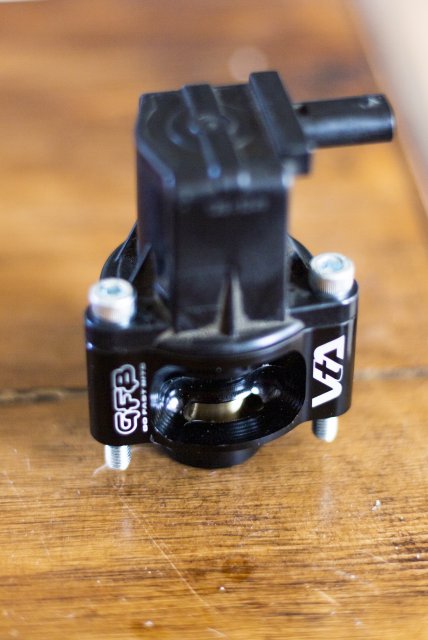

I was also able to install the GFB VTA - with the ITG intake it makes a hell of difference in noise.

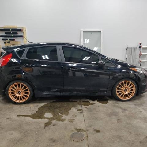

Purchased new wheels last night. I found a set of the 15 spoke SVT wheels. Going to clean them up and get them painted to some random ass color i like, (yet to be decided) and mounted on new Continential DWS.

I picked up a set of SVT 15 spoke wheels working on a color change :) bye bye white turbomacs. (for now)

Those wheels look really nice on there man. Not sure I’ve seen those on a FiST. That’s what’s up. How was the cruise?

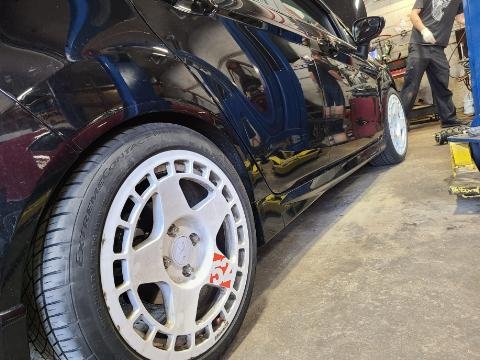

The tint job took WAAAAAY longer than it should have. I left my car with the guy at 8am this morning was originally told it would be done by 1PM, at 1230, it was delayed till 2, I didnt get a response at 2PM. I sent a text at 3 asking if i could come to shop and hang out for the remainder of the job.
He says yeah man you're more than welcome.
I walk in and just his facial expression i could tell it has not been a kind day for him, i initially felt like it was my fault like I did not do something that would've made this process less painful. After we got to talking and he let some of his frustrations settle, I learned that when your car sits on the Auto Lot for 12 months or you live on a dirt road, even if you have pets dust and debris build up in the window sills and windshield areas where he needs it immaculate cause MASSIVE pain when attempting to get as flawless coverage as possible.
He told me through out the day, that he had redone 3 windows at least twice, The windshield 2x. While i was there I watched him redo the windshield and the Pass rear window. I drove away at 6PM....
In the end I am super happy with the result, I would go back to him in heartbeat because of the love he has for his trade. I respect that he took sooooo much pride in his work and didnt settle. IMG_20200606_192449_842.jpg IMG_20200606_192449_837.jpg
check out my before and after
