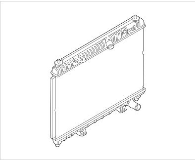

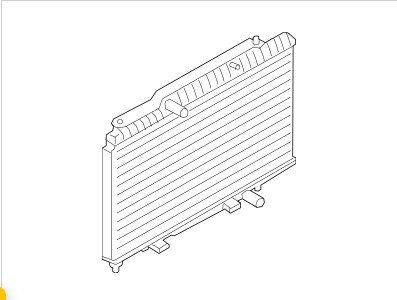

1st pic is ST radiator (C1BZ-8005-A)...2nd is SE (AE8Z-8005-B). I feel sure the core is the same but different top and bottom caps. Hence the claims they are the "same" I believe refers to cooling capacity.

Here's the part number for the radiator for the Fiesta with the 1.0 liter engine according to a parts site.
C1BZ-8005-B / Radiator
Here's the one for the 1.6 L non-turbo engine
AE8Z-8005-B / Radiator
Here again is the one for our 1.6 L turbo engine
C1BZ-8005-A / Radiator
lol Tasca did a great job of making them harder to compare do too the photos being taken at different angles and sides.
Great there are different part numbers . I have seen a lot of parts but pretty much the same part but different part numbers depending on what car it came in. NIssan did this all over their product line. lol
Plus they would also supercede old part numbers with new ones over the years of manufacturing models.
So I have learned to not take different part numbers as shear gospel that its actually a different part at all.
In this case from looking back and forth at those pics what I see is end design changes. Which of course would make sense. The real test though is the size of the core. Next time I get a chance and go to the junk yard I will closely look at Stock Fiesta core and take mesurements to compare to my stock radiator which is in a closet.
I still stand by my assertion that the radiator i.e actual core is the same size as a stock Fiesta till someone comes up with actual proof as different part numbers tell us nothing but that there are different part numbers . lol

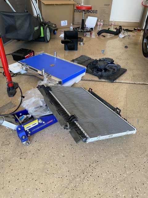

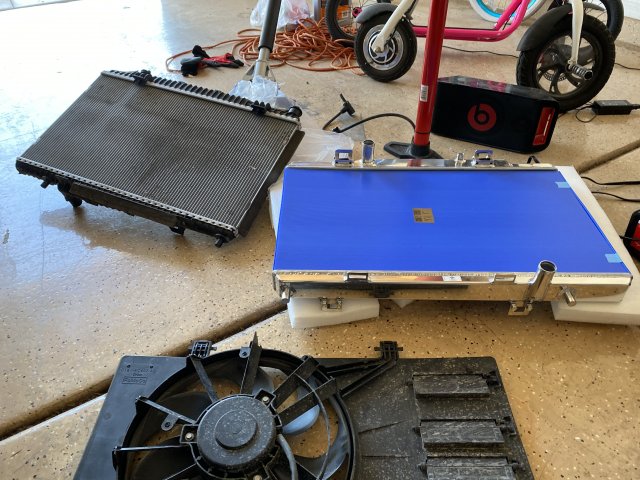

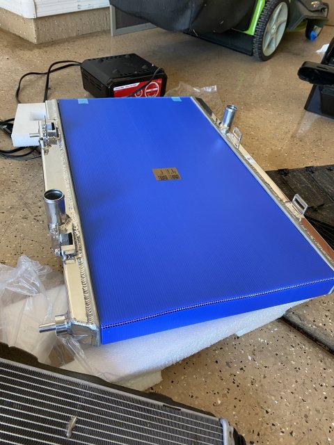

Finally got my Mountune radiator on yesterday, and gave it a shakedown cruise today. I covered most of the driving scenarios in this area, from carving back roads to stop and go city traffic to highway cruising, the latter two with the a/c on. It was showing 89 F ambient at the time, and it stayed between 185 F and 193 F on the coolant temp. That's probably the main thing I observed; the coolant temp is just a lot more stable. The stock radiator swings a lot more wildly, and spikes pretty fast on pulls. None of that was observed with the Mountune. (y)

Wanted to add one more update. Even being extremely careful I still broke my brittle bleed screw when trying to remove it so I would really recommend having one on hand as the nearest in stock ford dealership was about a 3 hour round trip.
Anyways back to the performance of the mountune. I’ve been doing courier-like driving for the past week (100 miles a day in stop and go city traffic) and it’s been 100+ every day and I even leave it idling at some of my stops and the temps hold at 190-195. So I can give a full endorsement to the mountune radiator with the stock thermostat that came with my 18. The stock radiator was getting to 6/8 bars within 30 minutes of city driving with lesser (but still hi) exterior temps.
