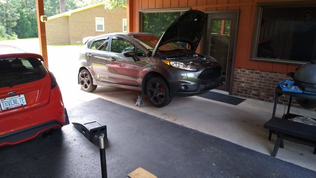

Everything went smooth, no extra parts needed other than coolant. I already had about 1 1/2 gallons yellow coolant from helping a friend with his install and it was enough. Still about 1/4 gallon left.
Some pics!
On the stands. I was two notches away from the highest setting on my pit bull stands and the rad had plenty of room to come out the bottom. Car is stock ride height.

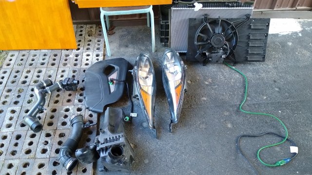

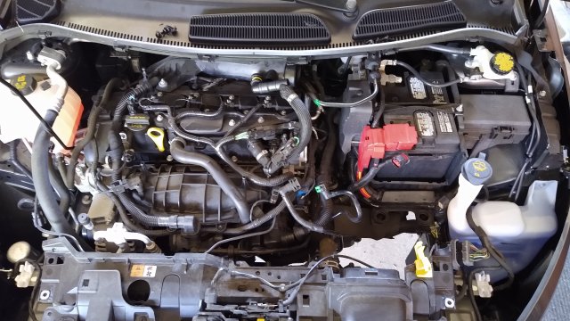

Intake removed. I took the headlights out too just for extra elbow room. Definitely not necessary but it's so easy to take them out and reinstall.
Cold side charge pipe removed, fan/hood sensor wiring and hood latch cable moved aside. The mountune instructions say to remove the sound symposer from the piping but I didn't find it necessary. It was TIGHT coming out from the bottom but definitely doable. I reinstalled the pipe from the top with the symposer still attached. I wish I had thought ahead about a symposer delete kit...oh well.
Old rad removed. I took it out with the fan shroud attached. Once I figured out the tilt the top out then lift from the bottom to remove it from the mounting holes, it was easy peasy.
All the parts removed during install.
The only part I had to transfer over was the bleed valve. I removed the top two brackets for the fan shroud from the mountune radiator and loosened the bottom brackets for the condenser. I installed the radiator by itself then added the fan shroud to it once I had the radiator secure. Everything went smooooooooth.

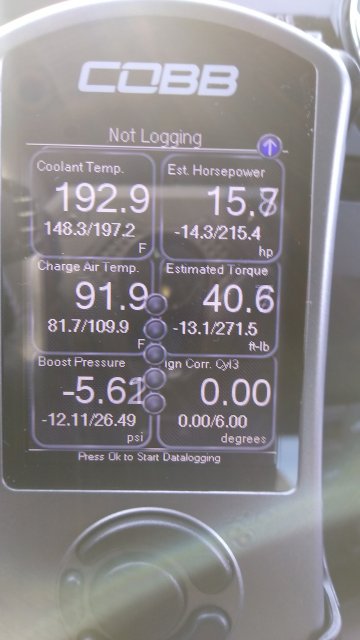

Also just got an accessport from mountune at the same time with stage 3 93 tune loaded on it. I still have the stock intercooler but it's good enough for now. This is my wife's car at the moment so it doesn't get pushed hard. Car feels good.
