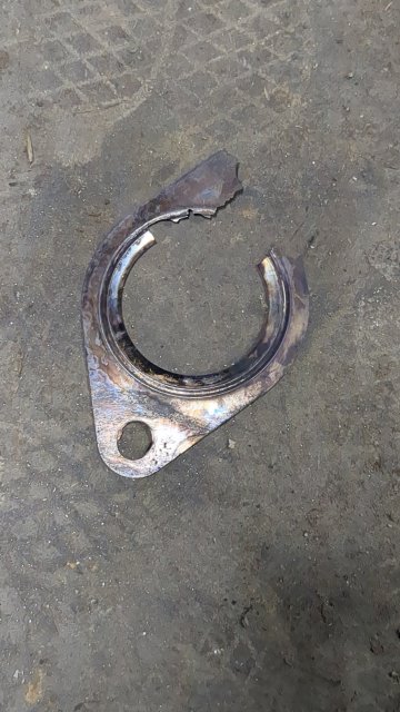

Hello and thank you for the responses in advanced. I just picked up a new to me shop exhaust, and after install I went for a test drive as you do. When I accelerate after about 3800 rpms there is a loud almost super charger whine sound that starts. It goes away when I shift and doesn't start till that same rpm range. Wondering if anyone has any ideas. I have videos but it won't let me attach them

Definitely not turbo noise. May be an exhaust leak where it isnโ€™t fitted correctly? In the video it seems to be happening only in boost.

Yeah I have off the next 2 days so I'm going to put it on the lift and check for a pin sized hole right right after the downpipe. Also check to see if I tightened everything down. It's weird tho for an exhaust leak because the exhaust isn't louder in the traditional sense of having a hole In your exhaust ๐Ÿคท

Okay so I'll upload a picture when I get home but it was the gasket between the downpipe and exhaust. Also, I built my intake so ik it's not leaking there ๐Ÿ˜‚ ( random leaks starts)

Glad you found the culprit. I'm waiting on a new catback, and I already got a new gasket for when it goes on.
