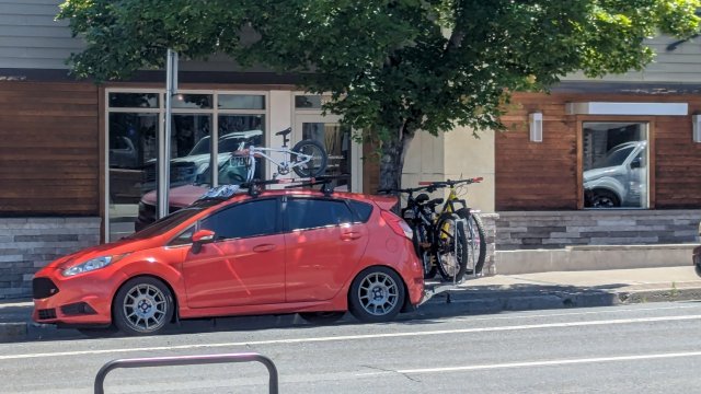

Yeah, a 1Up Qickrack + one extender is 45lb. One modern full suspension mtb and a hardtail come to about 60lb. Not sure how much the hitch weighs. 20 lb maybe?
