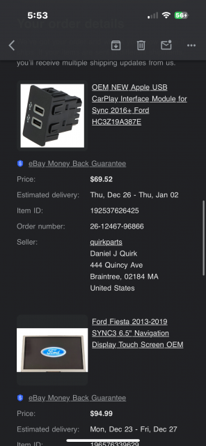

screen - https://www.ebay.com/itm/1965763396...cFlxjUnQuO&var=&widget_ver=artemis&media=COPY

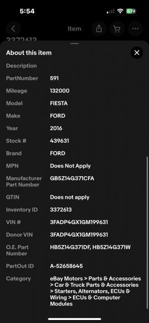

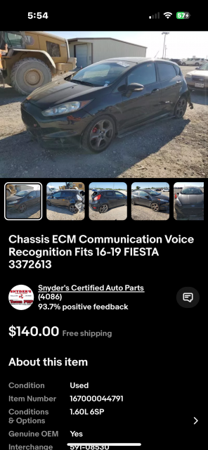

apim - https://www.ebay.com/itm/2753531276...cFlxjUnQuO&var=&widget_ver=artemis&media=COPY

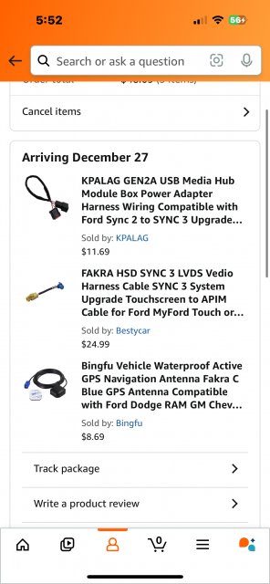

gps antenna - https://a.co/d/gdQk2ti
usb wire adapter- https://a.co/d/cpLsRlo
screen to module - https://a.co/d/3oPNfDt
usb hub - https://www.ebay.com/itm/1925376264...cFlxjUnQuO&var=&widget_ver=artemis&media=COPY

For anyone who may be following I have been doing research basically all day and have some up with this list.
Once I get up and running I do plan on using CyanLabs to upgrade to sync 3.4, as I am not sure if the APIM im getting is updated.
That bring up another thing, I have found out that programming shouldnt be required if you get an APIM from a Fiesta with similar features as yours. If it comes from a different car (Escape, Taurus) it will need programming. I am sure you can learn to do that if youd like, but NaviUpgrade also offers a programming service if you decided to source parts yourself.
