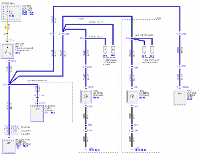

What's odd about that theory is he's able to selectively activate his high-mount by pressing the brake.
Looking at the circuit diagram for my 2016 (posted above), it doesn't make sense.
They're all on the same Blue-Gray identified as CCA26.
Only thing that would make any sense, is if the LEDs damaged the socket in a way that allows the marker light voltage to cross-over to the brake light.
To rule that possibility out, turn off your marker lights.
If the brake lights switch with the marker lights, there's the answer; damaged sockets.

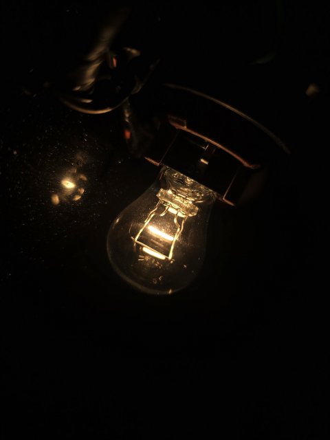

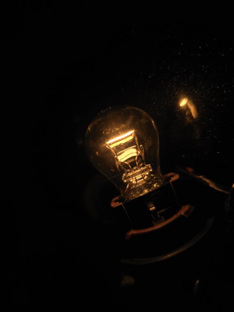

1st pic is what it looks like with brake on markers off. 2nd pic is markers on. So the marker lights and brake lights have been switched. Not sure how to fix this. I've tried flipping the bulb and no fix.

So as the first pic shows my brake lights are dim. The 2nd pic just marker lights on brakes released it's bright. Filaments have been switched. Not sure what would cause that? The socket seems fine I guess but not sure. I guess I'll try changing the harness and see...

All issues fixed! I found it was the wiring. The brake wire and marker wire were reversed a simple swap fixed the issues.
