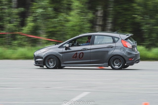

I never had a problem running 225/45R15s (in the Rival S or the RT660s) with Swifts on. There was some slight rubbing on the inside of the front fender liners, but just enough to barely scuff the plastic. I'm guessing this was from hitting bumps with the wheels turned hard on course while autocrossing. I don't think I ever hit a big enough bump fast enough to actually hit the edge of the fender, but it has come close...
I dialled in some negative camber with the coilovers, and think I have a bit more room now.
Do you ever have this setup out on the street at all, or are they transported off of the car to the events, put on, and then taken off after the event for the ride home?

Earlier this summer, I left them on the car for almost two months because we had events most weekends and I've been working from home during the pandemic. The biggest clearance issue I had was the Pierce 2 point brace bottoming out on larger bumps/potholes. Our roads up here can be pretty crappy, but our parking lots are even worse.
It has gotten better since I went to coils- the stiffer springs keep me from hitting the brace unless I'm doing something silly (I have about the same static ride height). The coils also gave me about -2.5° camber in front, and I added Depro camber plates in the back (-1.8°), for even more clearance.
