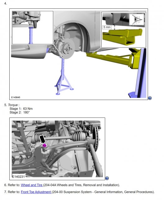

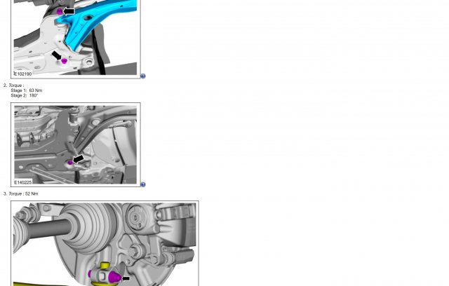

Does anyone have accurate info for the three bolts torque specs. Sorry, having trouble finding consistent accurate answer. I'm replacing them in a few days. Thank You!

Thanks for sharing this @haste its really helpful. Can you kindly advise the name of this source? Or where I could find similar information on other torques specs?

It's from the factory service manual. I found it widely available on the internet in the form of a disc. Google/Bing is your friend.
